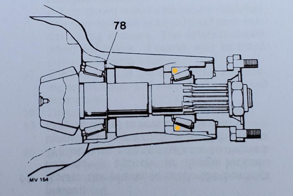

    Last question: Is it possible to change the rear output bearing on the front differential from the prop-shaft side, with the diff in the car? I mean, can it come out strictly from the rear (without removing the axles, gear assembly, etc and tapping/pressing it out from the front?)
    [Edit] This last part sounds impossible. Cross section image attached, with bearing race highlighted in yellow.

    Hmmm... Try using 75/90 (or 80/90) Lucas Oil, it's good stuff, I use it in diffs, transfer cases and, transmissions. Why change a bearing because of an oil seal leak? Unless there's a lot of play in the shaft. First check your axle vent and be sure it's clear, if the vent's clogged it will build up pressure and cause any seal to leak. Changing bearings on the diff INPUT shaft will require you to take it all apart and set everything back up (back lash) when you're done. The seal itself can be changed without tearing everything apart. Also, heavy oils in the right conditions can build up excess heat resulting in excess pressure. I only have to worry about heavy oil in my diffs as my '76 S3 has a massive LT95 trans/transfer case combination (it's a one piece affair), with overdrive. It uses 20-50 engine oil and has an internal oil pump.

      Why change bearing for oil leak?
      Probably won't, now that I thought about it. I had a sqweek develop along with that oil leak. Sounded like it might be coming from that area. I thought it was suspicious. So I ordered new U-Joints, too. While I was at it, I ordered all service-able components in the area. For some reason, everything takes 3 weeks to get to me - and this was exactly like that. I got a call back from my supplier(not Rovers North, for these items) a week after ordering parts that there was a 6-8 day delay. Anyway, time is worth more than an extra $30, so I bought a Timken bearing, too. Why not? I was expecting to take the oil seal off and find a mess. Then what? Wait another 3 weeks for parts? Nah, I ordered the bearing, too. I was worried that maybe it might not be the 120weight oil? Maybe a wobbly propshaft/U-Joint setup enlarged the seal opening? It was a theory...probably wrong. Extra parts go on the shelf, I guess. I'll need them eventually.

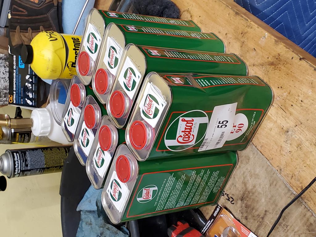

          Just got my shipment of liquid gold...$15 each. Can you believe it? I'm going to go broke driving this car!!
          Service manual says to replace this stuff every 2 years or so. Hmmm...someone over at Castrol and Land Rover teamed up for profits, here. I don't like it... I don't like-it-at-all :/
