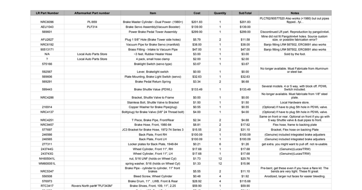

    You can find a spreadsheet with full part numbers and honest costs for the entire project here:
    In the end, it cost about $2000 for the entire system. I initially ballparked it at around $750, so there is that - things ALWAYS creep! Which is why I decided to share the full cost, so that you know what you're gettting into(if you want to do it too). At the same time, I also did Hub Axle rebuilds all around (had everything off anyway) so there is some cost for that which isn't accounted for (I can provide that, too, if anyone's interested). Also, found some gouges in my halfshafts and bone-dry and pitted Swivel balls, so it turned into a bigger project...but the spreadsheet only goes into the brakes. Let me know if you guys would like the same for the other projects.

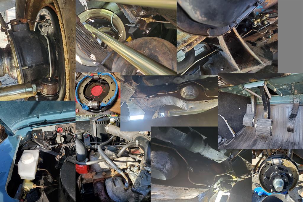

    Here is a collage of the highlights. Many new parts!

    * I bought pre-cut and pre-flared lines initially. These turned out hard to work with, because the lengths are just estimates. So, as you route them around, you end up with too much or too little (usually too much) and it makes for awkward routing to get rid of excess length. Invest in a nice flaring tool and just get 25 feet or so of coiled line. The only exception I would recommend is the line that connects the wheel cylinders in front. Those are bent excessively at like 110 degrees right next to the flare fitting, which is tricky to do. It's worth just getting those (~$8 each) pre-bent and flared since they are small and fixed dimensions.
    * Needed vacuum tap from intake manifold for the Vacuum Booster. You may need to tap your intake, if it doesn't have a hole. I also have a spare "tapped" intake- which I bought but never used - if anyone needs it.
    * The PDWL valve bracket doesn't exist anymore., So you have to make it.
    * The Brake pedal return springs available don't fit the Pangolin 4x4 fabricated brake tower. They are too long. So, either get new custom generic springs, or make up a bracket for them.
    * The Brake light switch is different from single to dual line. It moves to the top of the brake tower, and is a basic brass plunger, not driven by brake fluid pressure anymore. This brake tower option has some additional parts not available anymore, so I had to make them (see my other posts). There is also the option to just use the same plunger on the front of the brake pedal arm inside the car. This is how modern cars do it, and easier to tune. I would recommend this option instead of trying to re-create the brake tower top mounted setup. I just made a little bracket out of a bent piece of plate with a couple holes drilled in. I left space on the bracket to drill out for the brake light switch, in case I want to do this later. But I would recommend doing this bracket because it eliminates about 4 finicky parts in the Brake tower. (See pic).
    * Be very careful not to mix American and British brake line fittings! Use one or the other. They will screw in to each other, but only a few threads and won't make a hydraulic seal. So, don't assume! Get the right ones. My system is a British double flare (DIM). There are only 3 sizes (2, really) for most of the fittings...so just stock up on a 10-20 pack of each and take it easy threading so as not to strip anything! It was an exercise in patience. Just do everything hand threading and loose until it all is almost snug. If it feels tight after 2 threads, you're stripping it and it will leak!!
    * The PDWL/Shuttle valve was a little tricky to bleed, but easy once you wrap your head around what it's doing. (See my other recent post.)
    * I have not hooked up the PDWL dash light yet. I wanted the valve for it's automatic safety shutoff, not the dummy light. So, the wire loom for that would be an additional cost - if you want to add that.
    * If you're getting new backing plates (which I recommend!! I only got new front and re-used the rear ) - prefer the integrated brake adjusters from the factory!!! They are welded on and solid! I got a set of those screw-on brake adjuster kits and they are JUNK! The spire is supposed to crush onto a soft metal snail shell to secure the thing. But it doesn't crush down very hard and slips. So you go to spin the adjusters and they just spin without adjusting the brakes. I had to add some washers to force it a tighter fit. But the integrated ones from LR welded to the bolts on the backing plate are preferable! For the back, I blasted the backing plates down to bare metal and used a Eastwood rust inhibitor to treat the original backing plates. I worked the integrated adjusters with some oil to unseize them. But they were very loose after. But I just can't accept the bolt on adjusters. They are terrible! So, I would recommend just buying new backing plates, and you get brand new(or NOS) integrated adjusters there. It's worth it.
