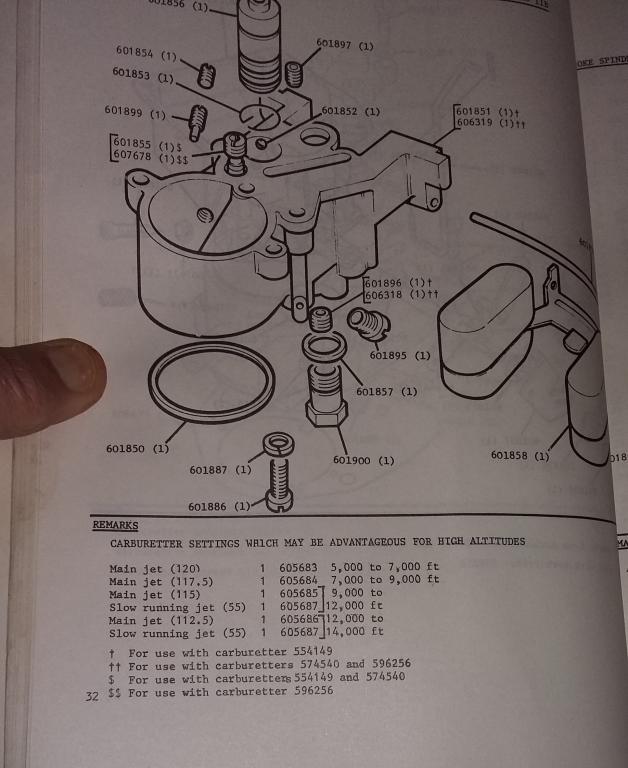

        Rover list alternative jetting in the parts book for extended running at altitudes above 5000 feet. This is from the 2a parts book for the Zenith Cab. I am no expert but surely using the choke ( which cuts the air flow and enriches the mixture) is the opposite to what is needed for altitude. Fixed jet carbs run rich at altitude and need weakening off not enriching. The Rover list is showing smaller jets for greater altitude.
