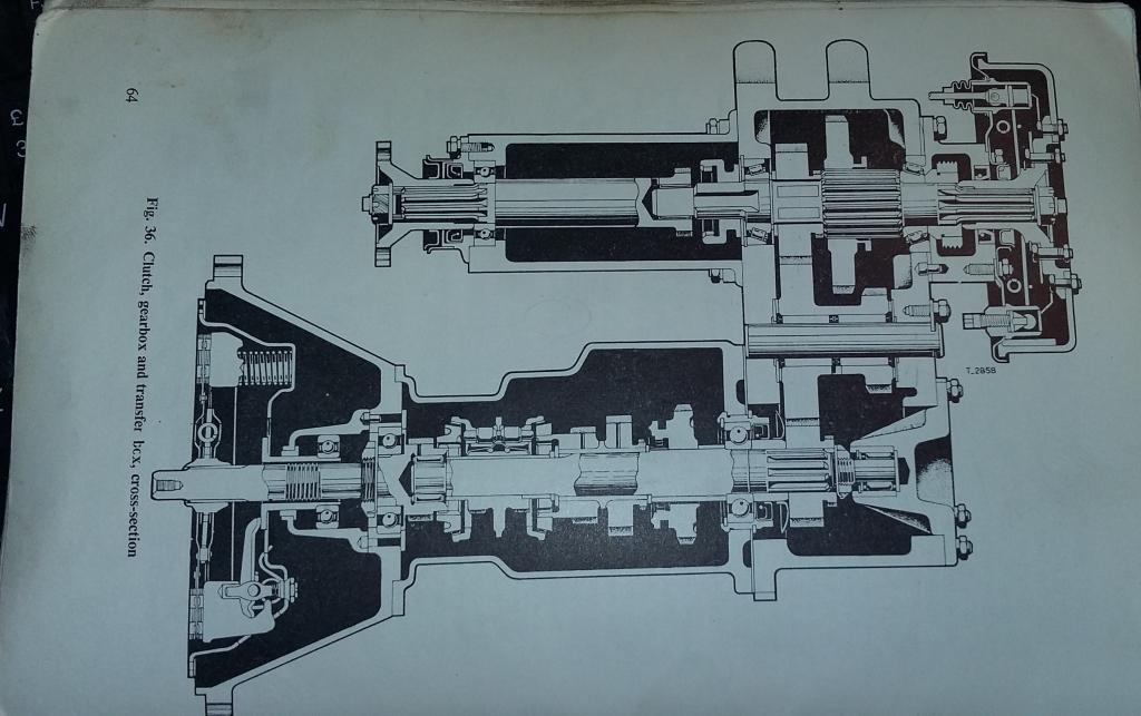

    As the box is out of the vehicle you need to lock the shaft to stop it turning. Tighten the park brake adjuster so that the brake drum cannot turn & if that is not enough , engage 4x4 and lock the front output shaft from turning with a lever someway, as the front & rear will then be locked together. Picture attached showing cross section through main and transfer box
        Thank you @Roverp480. Excellent visual there. I see that locking the front output shaft is key. On a side note, I had not yet torqued the nut on the front output shaft, so will address both of them.

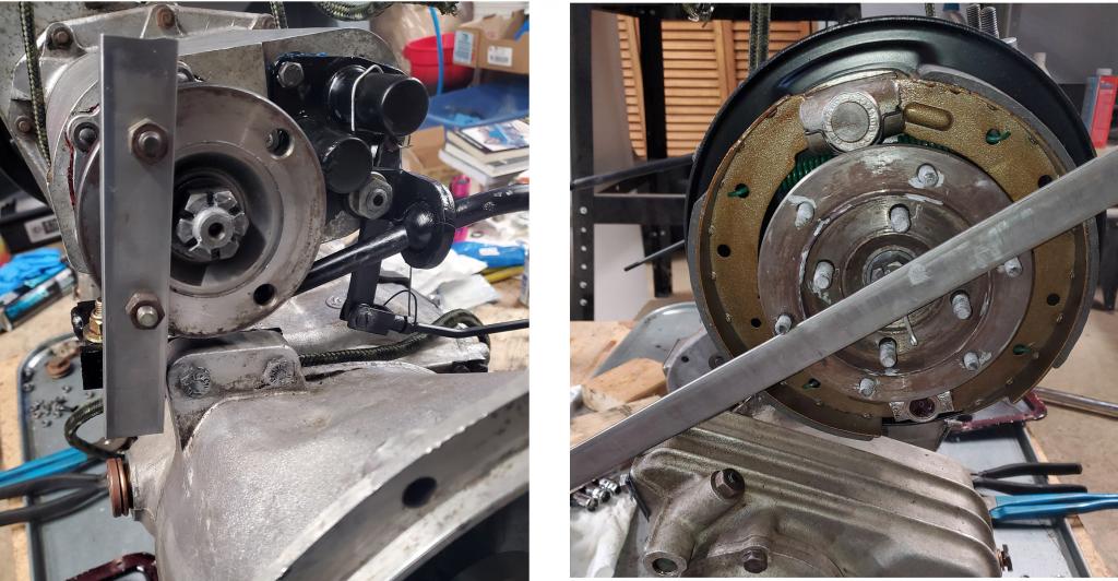

            Just wanted to say thanks for all the replies and input on this question. In order to tighten the castellated nut for the front and rear drive pinion, it is necessary to lock the drive so it doesn't rotate when you're trying to tighten that nut. As pointed out, if the gearbox is on the bench, you don't have the benefit of the brakes and tires on the ground to prevent spinning of all the gears when you're tightening one of the nuts. I made up a quick tool with 1/8" x 1" steel bar to bolt to the front output flange that bears on the aluminum bellhousing when tightening the rear pinion drive bolt. When tightening the front drive pinion, I used a longer piece of the steel bar to bear on the bolts at the rear to prevent rotation. Hopefully this picture will clarify what I'm trying to describe.
