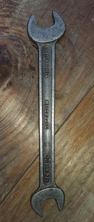

    Bolt is 3/8" BSF (British Standard Fine) on a 2A/3 , it has a Whitworth thread form which needs a correct BSF Spanner/Wrench on the head, which is nominally 0.601" A/F . Whitworth spanners are marked with the thread diameter not the Across Flats size of the head as per American and metric wrenches. So a 3/8" BSF spanner fits a 3/8" dia. BSF Bolt/Nut . Just to compound matters a spanner may be dual marked with two sizes , BSF and BSW . BSF being a fine thread and BSW (British standard Whitworth) being a course one . The Whitworth thread form has rounded crests and roots, has a flank angle of 55 degrees and usually different pitches to Metric and American thread of similar size. I guess a 15mm socket would fit, but may be slightly slack.
    A lot of the axle & gearbox parts on a 2A have whitworth fixing as they carried over from the S1 which was all whitworth including the engine and all body fixings. The S2 started having the, what are termed, Unified fixings in the UK, which used the standard American thread form & terminology .
    I have had this spanner for 50 years now. and you can see the 3/8 BSF end is worn, as its a common size on Land Rovers!
