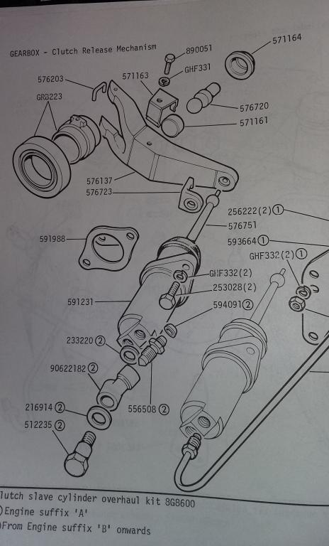

          Its possible the lever 576137 inside the clutch housing has worn . It pivots on a ball and can wear through . If you are getting full throw of the slave cylinder , it may not be pushing on the clutch release bearing.

            Is anyone aware of another way to verify whether the slave cylinder rod and bearing lever are OK?

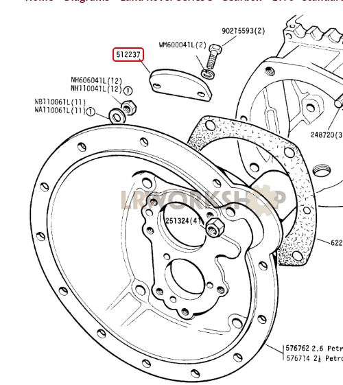

                          There should be an inspection plate on top of the bellhousing, held in place by the front bolts of the gear lever mounting bracket. I think its main purpose is to give a view of clutch plate condition, but pulling that bracket and removing the plate would give you a way to see inside and watch what happens when the clutch pedal is depressed. Bracket and main shift lever would all come off as one piece. You could use a small mirror or borescope to get a view of the movement of the clutch fork and throw out bearing. My engine and gearbox are currently out of the car due to a similar hard-to-diagnose problem. I only wish I had known about the inspection plate before pulling the gearbox. You do have to pull the floor and tunnel covers to get to it. Let me know if you could use any pictures.

                            DHager, thank you - that is a great tip! Exactly what I needed for verification before tearing out the gearbox. I have the left (LHD) floor panel out for easy access to the slave bleeder pipe. Will proceed to remove the center now. Any photos that come easily to hand would be great. Thanks again!
