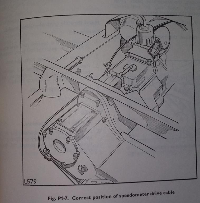

    Check that there is not a piece of broken cable stuck in the drive square , gearbox end . I had this and the cable broke and. damaged the speedometer. The inner cable should slide in and the outer abut the housing with no need to compress to fit
    Have you strictly followed the routing as per LR Manual ?

        I'd put my money on the speedo being faulty. Either that or the cables are improperly made. And the drawing shown is also incorrect: it's for a Series I. The later cables were meant to lead up over the top of the chassis, unlike the drawing.

          The drawing is from a LR 2A Workshop manual 606408, although I admit its the 1st edition dated March 1969

            Yes, that’s the same picture that’s in my green bible, too. When you say it goes over the chassis, do you mean between the chassis and the floor?
