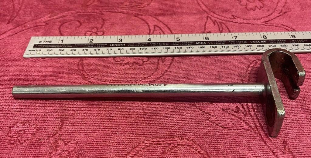

    This tool in helpful , hook it over the end of the shoe to lever it into position, and its a straight pull. The slot in the hook is to clear the centre web on the shoe. Similar item eBay item number:334128424972
    Is there not a local Auto shop who could make a pipe up to fit ?

      @Roverp480: That tool looks great! All the spindley plyer-type drum brake tools at the local auto parts store are junk! I bent them like a coat hanger trying to stretch the spring into place on my Rover.
