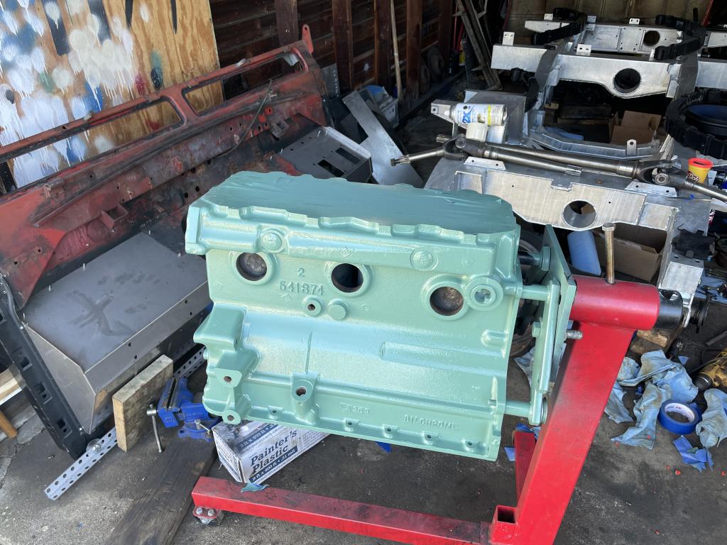

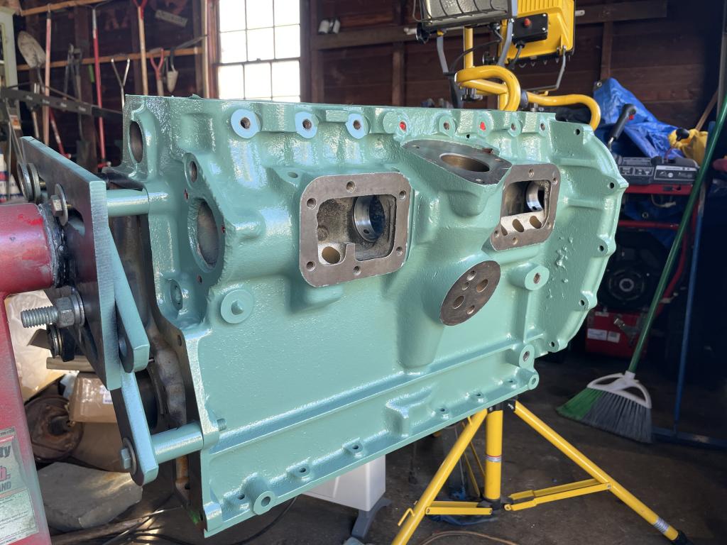

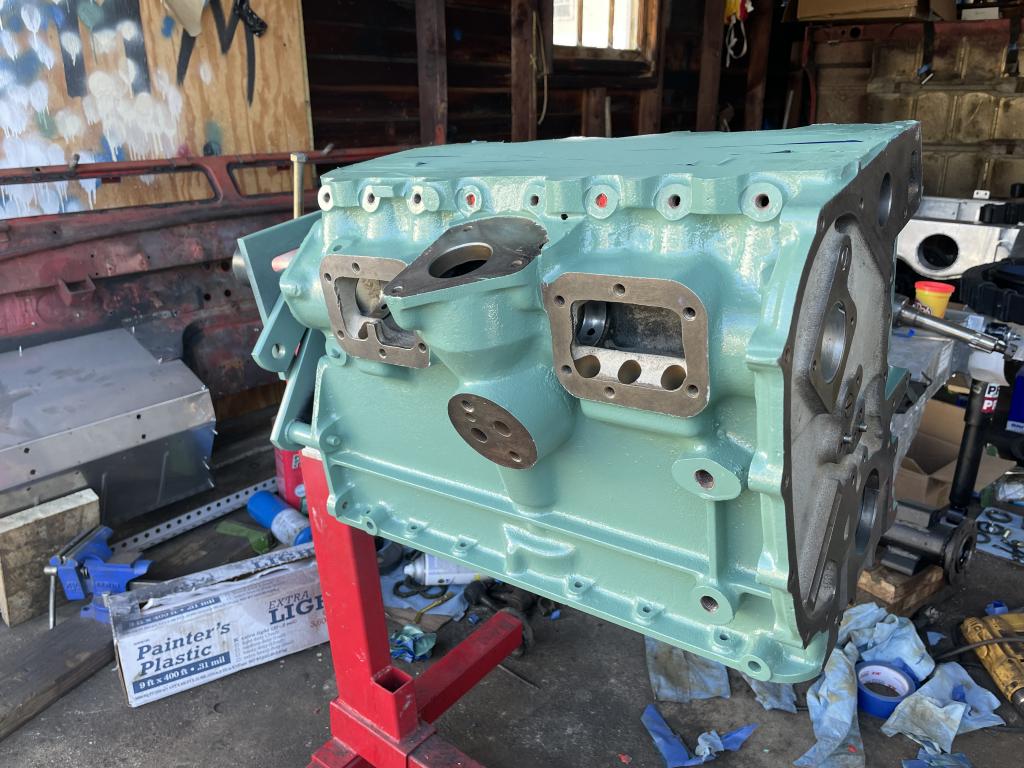

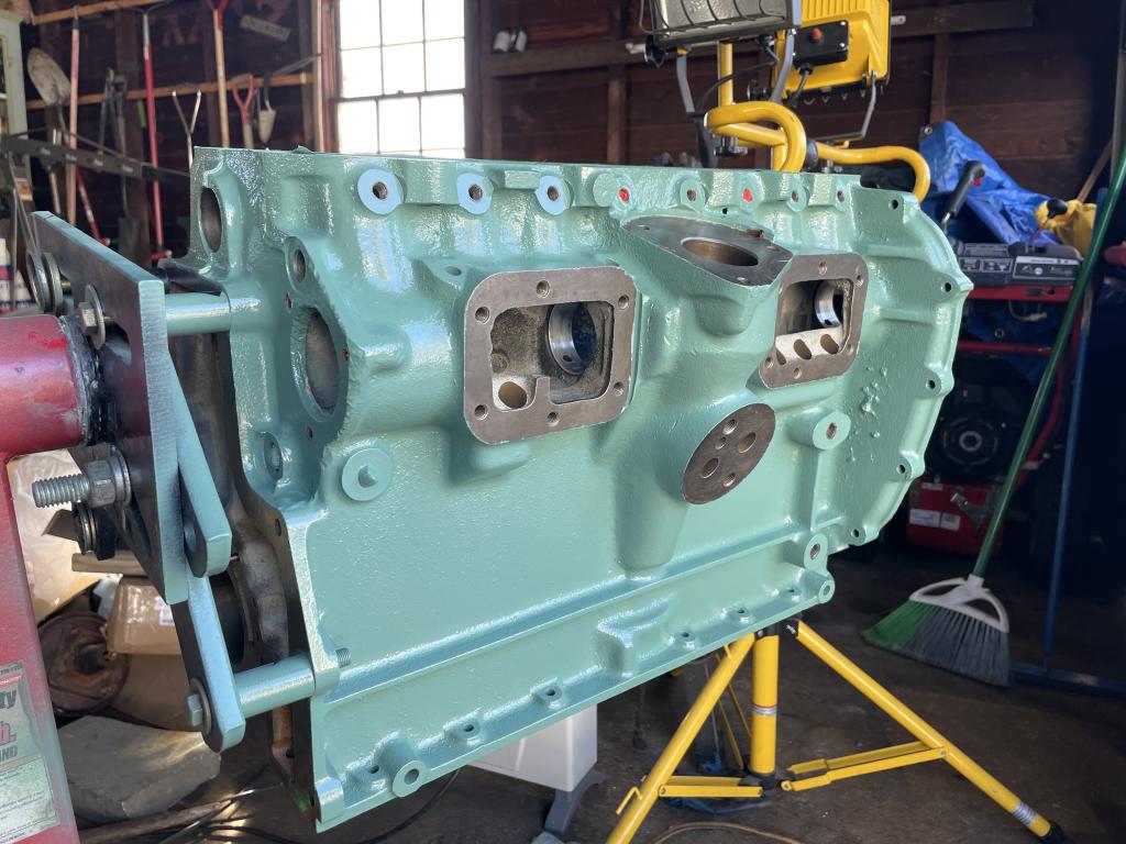

    Hello. I wanted to post some feedback on my engine and wheel color choices for my 1969 2A restoration project.
    For the engine I used Detroit Diesel Green DupliColor Engine Paint with Ceramic. I applied 2 light coats of the DupliColor Engine Primer with Ceramic and then 2 light coats and one medium coat of the the green. I waited 15 minutes between coats. Part of my process was to put a large cardboard box over the engine and stand and run a space heater for about 6 hours to help cure the paint.

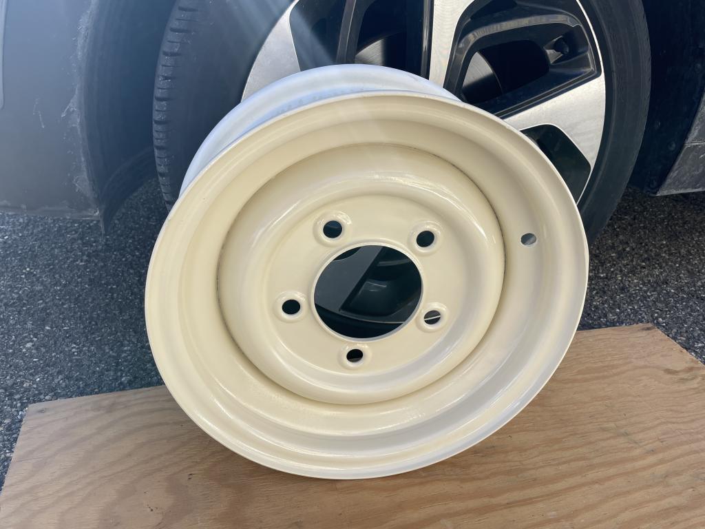

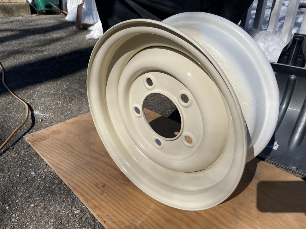

    For the wheels I used RustOleum 2X Gloss paint in Navajo White. I think it is a good match for limestone. Plus what a great name for a paint color choice for a Series truck. Still not perfect but close. I had the wheels sandblasted and then I primed them with RustOleum Rust Reformer in a spray can. Just to diminish the chance for rust to develop from the seams. The primer was left to cure for several weeks. I then did 2 light coats of the RustOleum 2X Gloss White and then 2 light coats and one medium coat for the Navajo White. I waited 15 minutes between coats and I did the same cardboard box heater cure step. One picture of the wheel is in sunlight and the other in shade.
    A note on the RustOleum 2X paint. I am not sure but I think one of my cans of Navajo White might have been defective. It left a rough texture on the wheel. I can only guess that maybe the primer portion of the paint was not the right proportion? My advice is to always spray a test sample. Wish I had done that : ).
    Hope this might help someone else with these choices.

    Great tip on the Detroit Diesel Green! I was tempted to try Pontiac Engine Blue, but your choice is much better.
    • Poppy1969
      Low Range
      • Jan 2022
      • 51
      #3
      Hi Ray. I had actually considered the Pontiac Blue myself. I am by no means trying to build a concourse truck but I had seen other people go with the Detroit Diesel Green and I am glad I did. Pangolin4X4 actually sells a aerosol for possibly a more correct color but it is pricey. Let me know if you want maybe some additional higher resolution pictures. The ones that are downloaded to this forum are quite a bit compressed. Tom

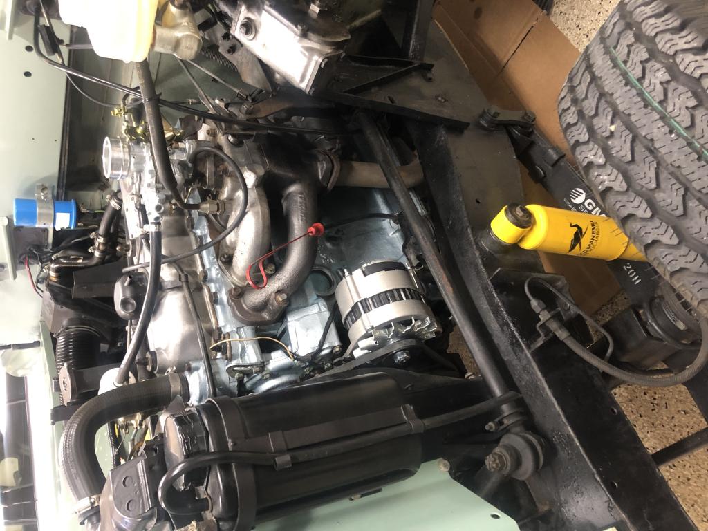

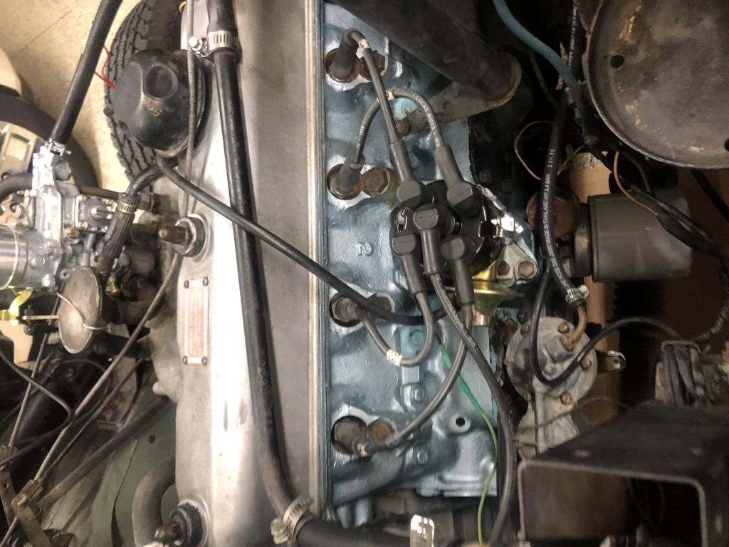

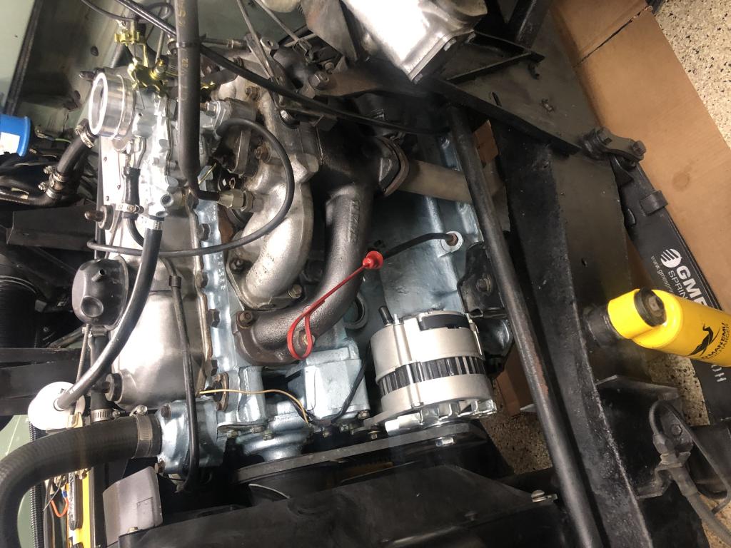

              Tom, I tried the GM Alpine (Detroit Diesel) Green. As perfect as it looks on your engine, it just didn't look as good on mine - maybe the contrast with the Pastel Green body was too much. I went back to the first plan and painted the engine Pontiac Blue. Although it is not as blue as I had hoped, I think it turned out alright. Finishing up the reassembly this weekend.

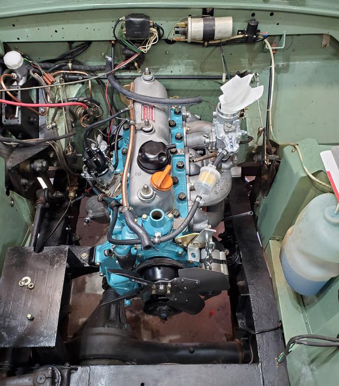

                I went with the blue and have been happy with my choice... until now. The green looks great.
                Don
