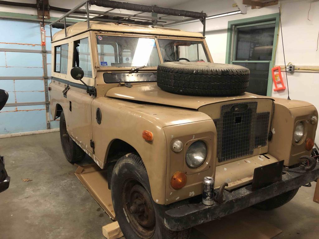

    I am in the middle of reviving a long dormant 1970 series 2a 88. Time has taken its toll on the rims and they are going to need to be sandblasted and painted (or powder coated) and reshod with new rubber. I'm not sure it's worth doing that if I can locate 5 used rims that are reasonably close by. Besides slapping freshly painted rims on a weather worn 88 is just going to look plain weird.
    Anyone in Vermont or New Hampshire have 16" rims they may part with that fit my 88?
    Also would love pull the hard top off and replace it during the good weather with a soft top. So also on my search list in the same geographic region is a used (sticking with the theme) soft top, hoop set, and tailgate.

          Nope, these are not the wolf rims but the "standard" 16" rims. Looks like there isn't going to be much luck finding some decent used rims here in VT or NH so I may be forced to find someone to sandblast them and hope they are salvageable. But what I can't figure out is if these are the narrower or the wider rims. Seems the 88s came with a 5.5" rim and the 109s with a 6.5" rim? I measured the width of these and they seem to be wider than 6.5" even. Could I be measuring incorrectly using the outermost points of the rim? I assume I am and that they are the 6.5" rims.
          Tires? I'd love some suggestions on a tire that is on the tall / skinny side (what size???) that is A)not overly expensive and B)has a good mix of on & off road traction and C)looks proper on the 88. Aside from the cost I do like the BFG KO2 ATs.
          Suggestions on size and model? Currently there are very old LT235/85R16 installed. They seem a bit wide judging by the fact that the front windshield cannot lower over the hood mounted spare tire and be close to horizontal.

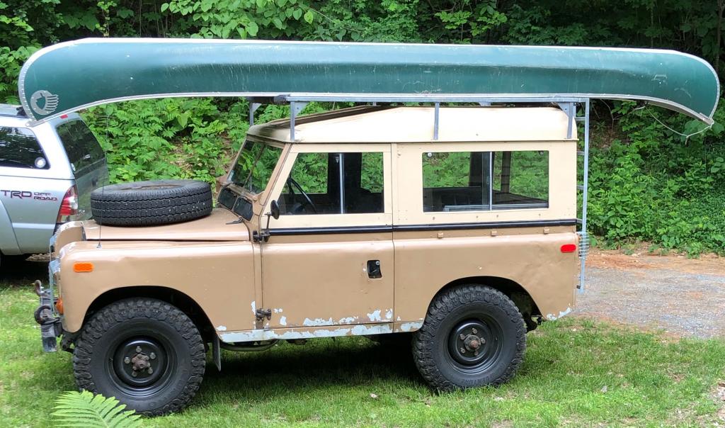

                  Thought I'd post an update on this search. A good set of used rims were tough to come by so I ended up purchasing a new set of tubeless rims from RN and mounted Kumho Road Venture MT71 in a 285/85/16. Balanced using ceramic beads. I like them and they are definitely aggressive and really not that noisy. The Rover far and away is louder at speed than the tires.
                  But back to the original post, and now that wheels are sorted, I am still hunting for a soft top, hoops, and tailgate for the warmer weather. Must be someone in the upper NE area that has this stuff unused in their barn or garage...
