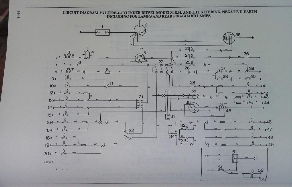

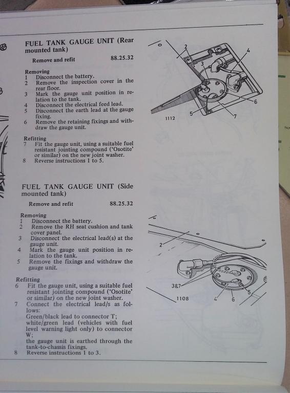

    According to the workshop manual the sender has just two "Lucar" connections . One as you say marked W to the warning light and the other marked T to gauge . The body is earthed through the tank sender unit fixings to the frame to make the final electrical connection . Some later sender units have a third Lucar which can be used to make a earth connection via a wire . This one can be identified as it is welded to the body of the sender unit whereas the other two are insulated, passing through the body to the connections inside. It may be worth connecting a black wire (to conform with the British color coding ) from the earth Lucar to the body or frame to improve the circuit. Your warning light should illuminate if you disconnect the W wire at the sender and touch it to the sender body. Presumably you have checked the bulb. You may have these but extracts from LR workshop Manual. Click image for larger version

      Thank you for the help. Indeed connecting the "W" wire to ground caused the low fuel light to come on. I really should pull the sender unit from the tank and test to see if I can get the low fuel light to come on. I do have the manual from which you forwarded to diagrams - the manual is good for telling one how to remove and install something but weak on diagnostics. All this started when my brake switch shorted and blew one of the 35 amp fuses. While trying to diagnose why the fuse was blown I pulled the instrument panel out and a few wires became disconnected ( finally found the bad brake switch and replaced it). Then I could not figure out where the disconnected wires went - then did something stupid and made my electrical problem worse. Had to replace the turn signal/horn button/headlight dimmer switch and the panel light switch. I have figured out what wires go where but one light function does not work ( fender side lights). Found the terminal on a multiplug behind the instrument panel that feeds power to the side lights by using a hot lead but cannot figure out why that line doesn't get power when the headlight switch is flipped to either the center or lower position. The wiring diagram in the manual shows that it should come off of terminal 7 of the main light switch with a red wire. There is no red wire to be found. My model is the County with driving lights attached to the front bumper and there is a relay to feeds power to these light, so maybe the wiring configuration in my truck is not exactly like found in the workshop manual. Thoughts?
