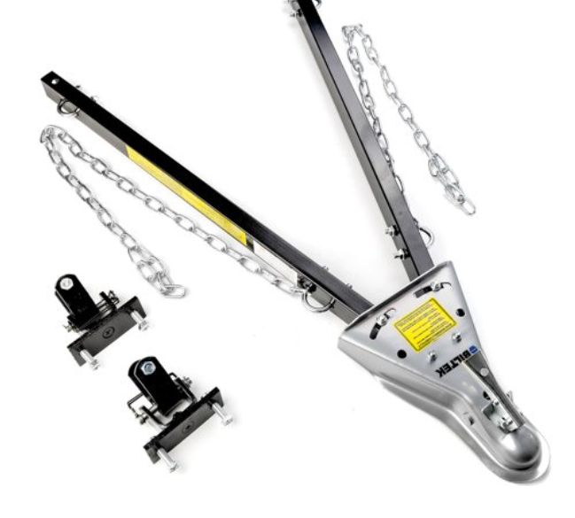

    Just wondering if anyone out there in Series land has any experience with towing a Series behind another vehicle via a tow bar? Tips tricks or lessons learnt? I want to participate in some off road adventures with a not-so-local club, but the 6hr drive in my Series without an overdrive (heck likely even with) would be both exhausting and hard on the vehicle (3 bearing engine). Not to mention limping home could be an issue.
    I could float the Series there, but parking my truck and trailer can become an issue (told by members of club).
    I came across a photo of a Series 3 with a tow bar on the front bumper and bingo the light went on. Do I simply disconnect the drag link? Will axle lubrication be an issue?

    #2

      If you tow the Land Rover with an A frame the vehicle will self steer without disconnecting anything , but the steering lock must not be in the locked position ,so you need to leave the key in the unlocked position. Both axles and the manual gearbox will be ok to self lubricate as none have oil pumps that need driving. Not sure as to the legality in US regarding brakes. In UK the brakes must also work as per a trailer.

        I was concerned that the steering wheel turn ratio was too high for smooth self steering. I would think there could be some tremendous load on the steering box. Thoughts?

                45 years ago I designed a towbar that requires no drilling of any part of the Land-Rover. Since then I've towed clear across the country and probably used it 1,000 times without incident. It does not use, or require, the front bumper. It works on any Series I, II, IIa & III leaf-sprung model.

                      Just to report back that I towed the Series 3 over 600km and it all worked out perfectly. I tow with a Dodge 2500 diesel and it is much heavier than the LR so accelerating and braking were a breeze. It even tracked around tight right hand corners without difficulty. I averaged 100km/h with a max of 110km/h (briefly). I did beef up the safety chains that came with the tow bar pictured above. I wired up plugs that spliced into the rear tail lights and into the trailer hitch plug on the truck. Now I have a wire loom that plugs into the LR in seconds. The tow bar has quick connects so it is easy to install.
                      I managed a 2.5 level off road trail with no breakages (or even getting stuck). All in all, a smooth trip.
