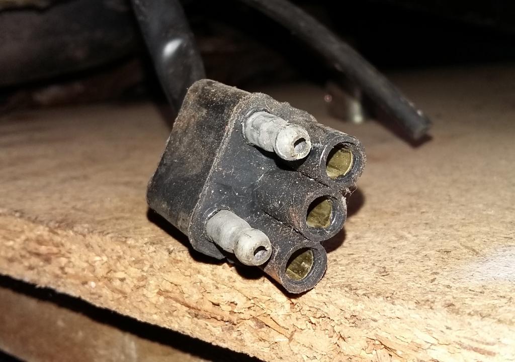

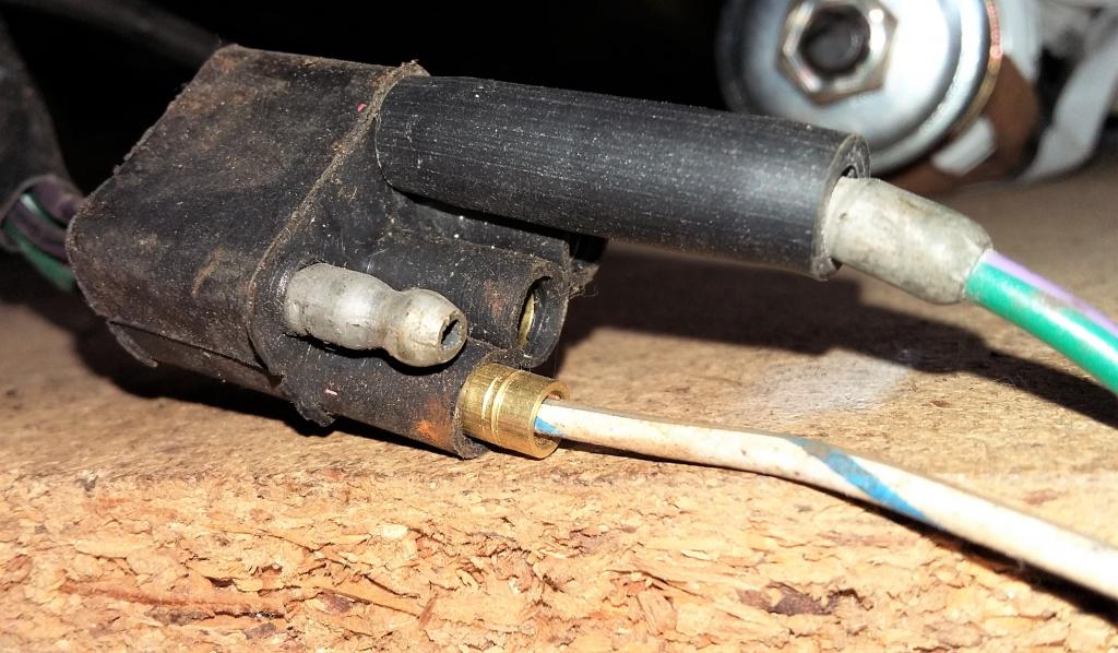

        My one observation is that Land Rover started using moulded plug connections with Series 3 harness instead of the "bullets" which predominant on the S2. But, to connect the 2A type connections , I have found that one can use male bullets on single wires into the female part of the moulded type and use a female bullet type sleeve onto the male part of the moulded one and then fit a single male bullet in the other end. Alternately one could when connecting the old to the new, cut off the moulded plug and solder/crimp on bullets instead. Hope this makes sense, but I have added a couple of pictures to help explain. NB Bullets not pushed fully home to illustrate. I would also suggest any wiring extensions use, if possible, the correct color coding for the wires as it helps immensely with fault finding down the line.
