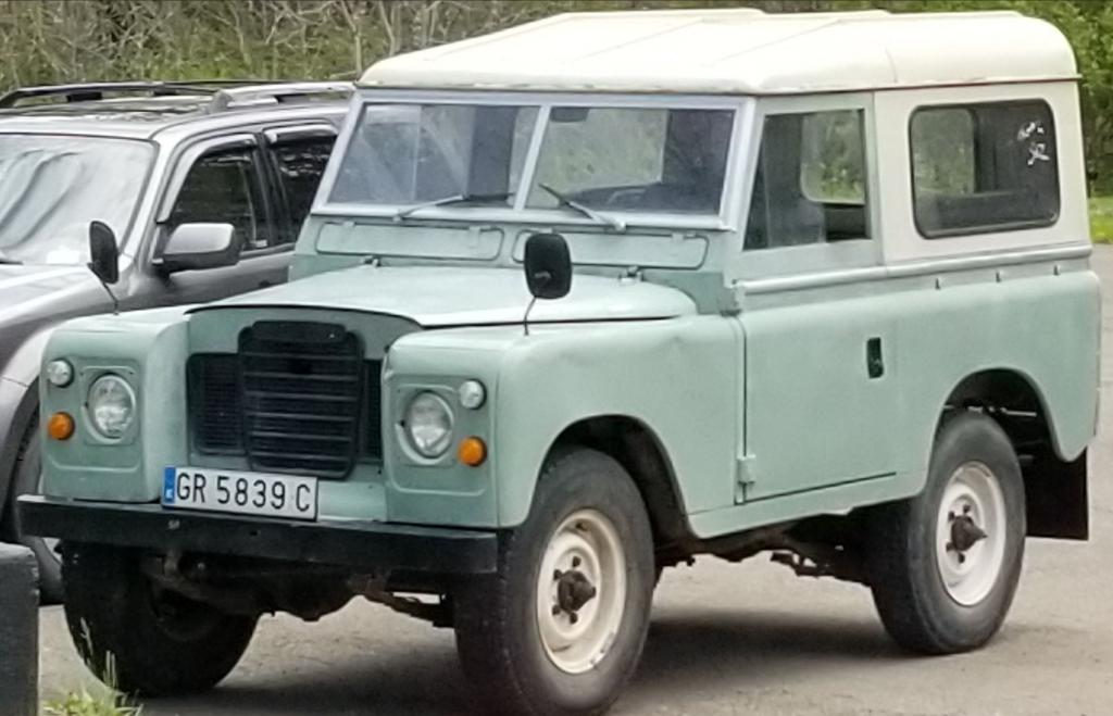

            Just a long shot,,, This 77 88 Series III Santana just sold. It had brake and clutch parts in boxes in the back. Is it yours Click image for larger version

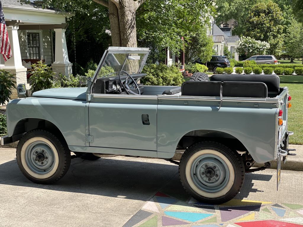

              • williamdmann
                Low Range
                • May 2022
                • 12
                #8
                Haha not mine! She’s running great now!
