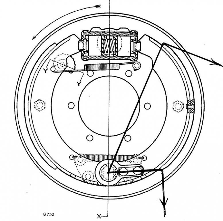

    I had this issue on 10" brakes when I put the brake pull off spring on the leading shoe back in the wrong place, I connected it to the trailing shoe, so pushing its piston too far back in , meaning I had to pump the pedal a few times before I got a solid pedal . The spring in the piston should just balance the bottom spring pulling the shoe back allowing it to "float" just off the drum
    Picture shows correct assembly ,courtesy of the Series 2 LR club forum. Front leading shoe to the left of picture, trailing shoe on the right

        Good diagram! I got curious after seeing the diagram and inspected the rear brakes ( 10 inch) on my late Series 3 88. I found the upper spring attached to both shoes instead of the post below the wheel cylinder. If my configuration is incorrect, how does the upper plate of the rear shoe stay attached to the rear piston slot or not rub the drum when the brake pedal is not engaged?

            * 109 Series III should have 11" brakes with two wheel cylinders on the front. It will look different than the diagram below. But the springs will still need to be on a peg of the backing plate and then one the shoe. Never attached to both shoes. The rear brakes on a 109 look like the diagram, though.
              The spring at the bottom between the two shoes is enough to keep the rear shoe in position against the slot in the piston, and the spring in the piston is also pushing that out so it stays engaged. . With the correct springs both between the shoes at the bottom and in the cylinder ,the trailing shoes can rub slightly but is always being thrown off the drum in normal forward motion and is hardly noticeable. I fell into the trap of putting the long spring between the two shoes back in about 1968 on my first Land Rover, a 1949 model, and subsequently had very long pedal travel , and had to pump the pedal to get the brakes on.

                First thing to do this morning is to move the upper spring on the rear brakes from the trailing shoe to the post below the wheel cylinder! Will also readjust the shoes. I have never liked the way my brakes work even after changing everything in the system. The pedal is hard and there is not much pedal travel but they just don't stop the truck like it should -- doesn't matter how hard I push on the pedal I could never lock up the wheels for a panic stop. I have a gradual stop so I have to leave a big distance between me and the car in front of me. Hope moving the spring on the rear brakes will help improve the braking, even a little.
