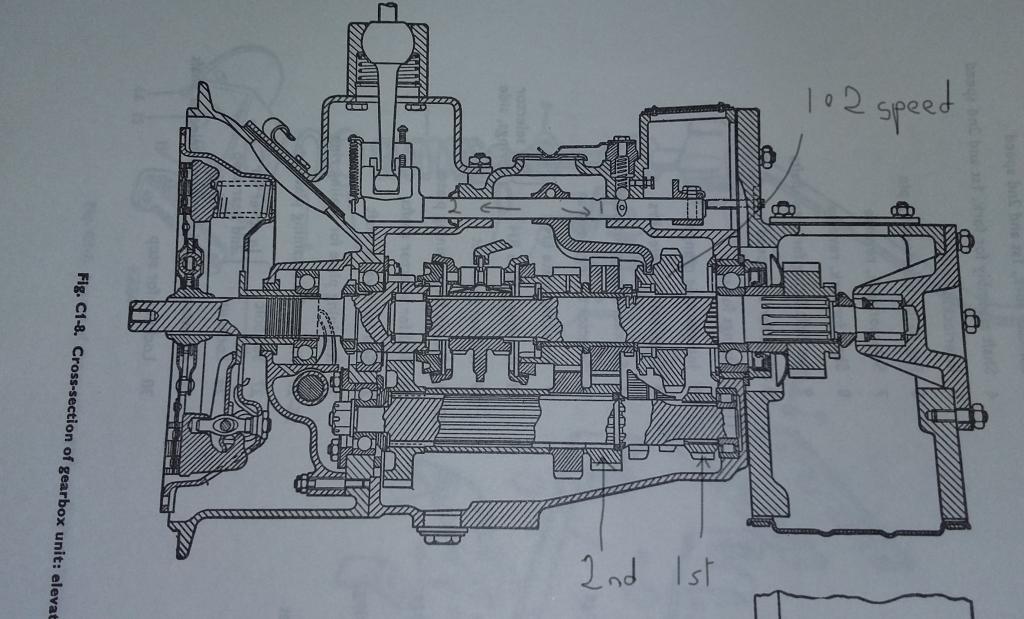

                As its happened suddenly ,it may be worth draining the gearbox oil to see if any metal comes out with it. I am wondering if something such as the bronze bush that the 2nd speed gear runs on is breaking up and jamming things. The S2A LR Workshop manual has a good cross sectional drawing that may help your investigation
Name:	20220607_222652 (3)_LI.jpg
