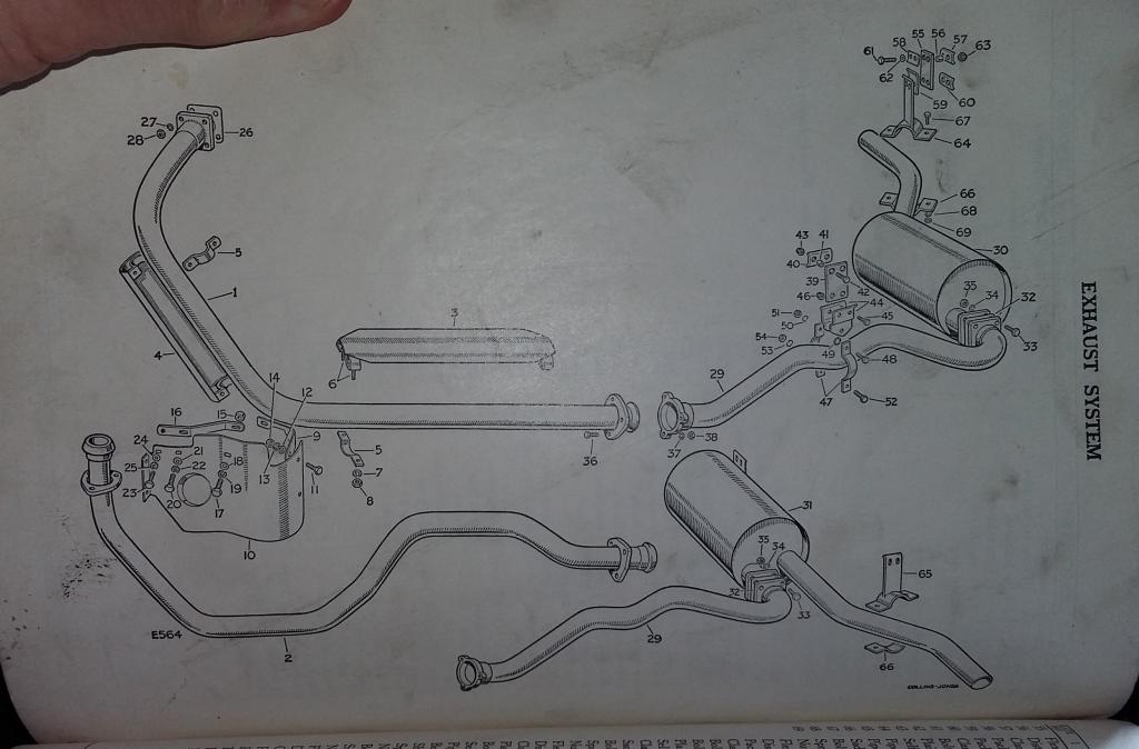

    I would also replace all the exhaust hangers , including the fabric flexible parts and their compression limiters ( Item 41 in picture)for the fixing bolts, as they are often omitted. Also replacing steel nuts fixing exhaust to the header with brass , helps next time they need to come off Click image for larger version

      Originally posted by roverp480
      I would also replace all the exhaust hangers , including the fabric flexible parts and their compression limiters ( Item 41 in picture)for the fixing bolts, as they are often omitted. Also replacing steel nuts fixing exhaust to the header with brass , helps next time they need to come off [ATTACH=CONFIG]13986[/ATTACH]
      Will do as you say.
