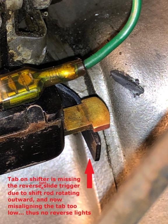

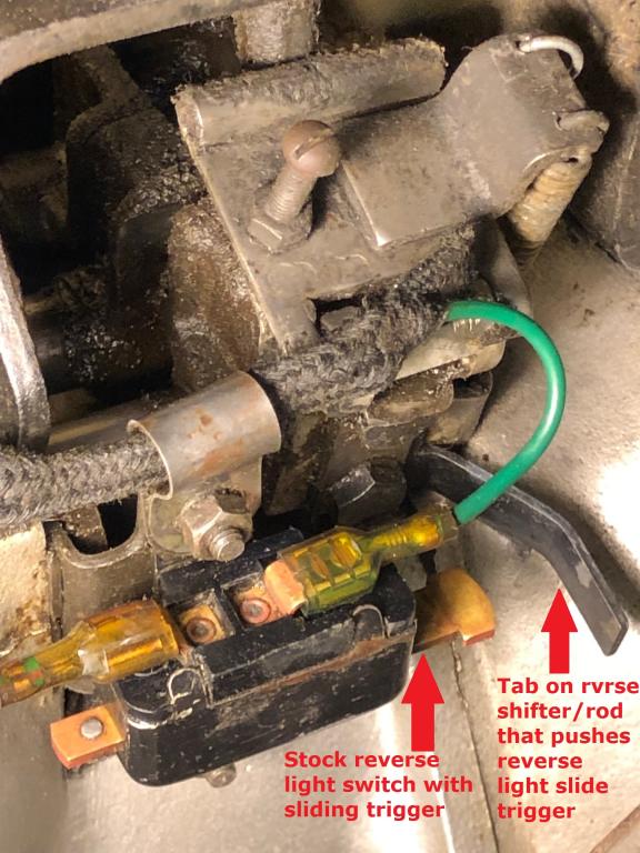

    Pics show original Lucas reverse switch slider isn't being pushed by the black metal tab when reverse is engaged. The tab is too low and missing the slider trigger...

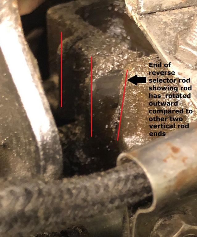

    Cause seems because the reverse selector rod is rotated 'outward', which directly results in the black push tab rotating downward, and becoming too low, ie: black push tab moves as one with the shift selector rod.
    Pic shows reverse selector rod rotated outward...

    I can get the reverse selector rod/black tab back to vertical with gentle hammer taps on a piece of wood but when engaging reverse again the rod and black tab just rotate again and the tab is back to being too low.

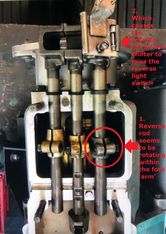

    I have a temporary solution until there's time to remove the gearbox cover (internet pic below) and try tightening the reverse fork/arm mounting clamp bolt at the selector rod (red circle in below pic).
    ...But a few questions before doing/trying all that:
    1. Does the selector rod have a notch or groove in it that the reverse fork/arm clamp sits in when tightened? (ie: curious if the rod could slide back and forth in the arm/fork mounting clamp if the clamp bolt is too loose?)
    2. How tight should the arm's clamp bolt be... is there a torque spec? (no luck finding it yet)
    3. Assuming my 'loose bolt' diagnosis is the cause, is there any harm driving it for a while with the reverse selector rod rotated? (aside from at some point possibly not being able to get into reverse)

    The selector shaft does have a notch/ groove , but there is an amount of slack to allow alignment of the two parts. The Series 3 manual states 20 lbf ft as torque and my fear of continues running could allow the bolt to come so loose it hits the case so you have bits of metal in the oil. or damages the thread such as to need a new fork. It would need a lot of use to do this but ! . When you take off the top cover make sure none of the detents and balls/springs get lost & fall into the box, worth following the manual about packing with grease. See attached picture

          Thanks for the thoughts, @vlad_d. On my set up it's the vertical axis being an issue, so my temp solution was basically as you mentioned; I lowered the switch temporarily so the push tab now hits the switch trigger. But, I don't want to leave it like that forever for reasons mentioned above. When I have time I'll take out the flooring ...again ...remove the gearbox cover and check the fork bolt torque, etc. I'll need a chunk of time for that job as I'll likely replace at least the selector rod seals at the same time, and I'm not the fastest "mechanic".
