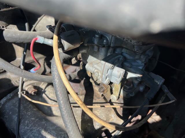

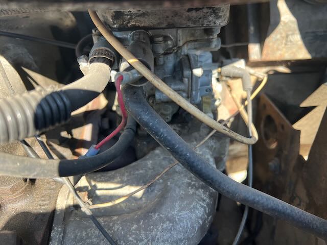

      I'm embarrassed to say that it has been running so well so long that I've since forgotten a lot of the painful and intimate details of this truck. For the life of me I cannot remember what the carb is... I know it is a strange and rare one. And I recall, for a long time at least, our hosts didn't have it. I searched my old posts because I recall having this issue 15 years ago, but I couldn't find anything helpful. That said, it was briefly in may dad's custody and he had someone looking at a brake line issue - that guy ended up replacing the carb ¯\_(ツ)_/¯ ... so that tells me 1. that it is quite new (less than 1000 mi) and 2. it is attainable
      I'm attaching some pics.
      I'm mostly curious what leads you to thinking it is carb, based on my description? Could it be the distributor (points or failing condenser?)

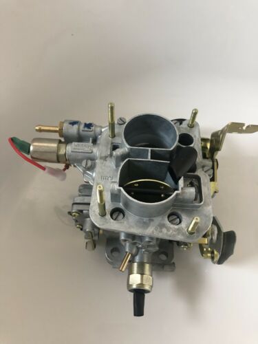

        The fact operating the choke sometimes helps could point to fuelling. I had an early One Ten , about 1983, and the carburation was an issue from new , part of which was gas vapour locking . Land Rover dealer had it back numerous times and fitted all sorts of new parts before it was eventually cured . A number of symptoms were similar to yours and your carb. looks like the correct Weber for that engine. It may be worth checking the two electrical solenoids are working correctly. One is to stop the running on, " dieseling" you experienced and the other is to help with hot starting by changing the air venting. I wouldn't discount a faulty condenser and that is an easy thing to change , even if it just eliminates it as the problem. Pic is of a new carb which I think matches yours.
