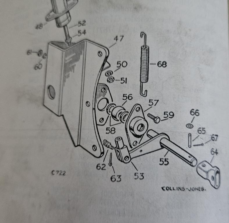

        Check that neither of the cross pins in the coupling sleeve between the release bearing housing and the operating shaft where it passes through the rubber grommet, have not broken . Often one end can break vastly reducing the amount of available movement . Item 65 is the pin and 64 the coupling sleeve , This is a picture of an early s2A but the principal is the same and the pins now often have a head on one end and just one split pin the other, also the spring 68 was deleted later on. I have had this happen a couple of times over the years. The pin being in two pieces and still in situ, so not obvious it was broken .

          Thanks - Yeah I've gone through the green book settings and just can't seem to get it - I'll double check the pins. One thing that I keep getting turned around on is the master cylinder setting. Should I slack those off and set the pedal with the adjustment bolt in the end of the housing and then tighten the lockups on the master to suit?
