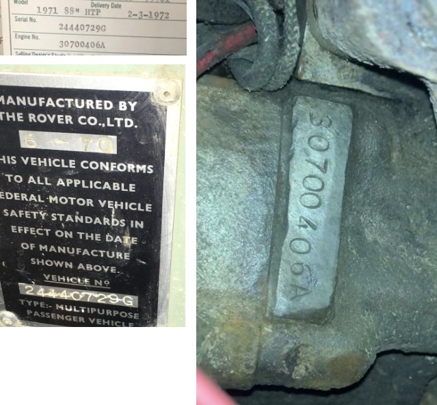

    Truck: 1971, 88", 2.25 petrol, IIA (24440729G / June 1970), with original engine #30700406A.

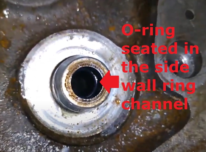

    Seems there are two types of valve stem seals for 2.25 engines (please see attached pics):
    1. O-ring that sits recessed down inside the valve guide tube wall (stem pushes up through it for the sealing factor). The O-rings are not visible when valve cover is off, since they're down inside the valve guide hole about 1/2". To replace them the head has to come off as I know it, and I won't be doing that job. In this case, I'd not take anything apart and just have my trusted shop do it.

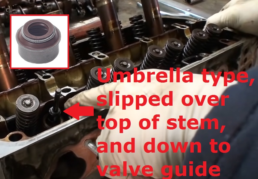

    2. An "Umbrella" type (as it's called) that simply slides over the already inserted and protruding valve stem and valve guide top. These rubber 'umbrellas' are visible with the valve cover removed, and based on numerous videos, they can be replaced with the head on, and just removing the valve cover. This I can do.
    Question is... before I take anything apart (possibly unnecessarily if I have O-rings), how do I know which type of valve stem seals are on the engine? (ie: Is there a known change over date / engine number cut-off from one type of seal to the other?)

      @roverp480... you're an anomaly - what would we do without you?! Thank you kindly for the (always) perfectly detailed reply. I'll see if I can find the timing pointer. But overall, with your good news I may as well optimistically remove the valve cover and check the seals, since my engine is original/numbers matching. Strange though that my engine (A) is much earlier than the LR engine change at (K) but my chassis (G) is later than the LR seal change at chassis change (E). Maybe Solihull had an abundance of suffix A engines that made it into very late 2A's... but that seems odd. I attached a pic of my engine info, just for fun. Thank you again - will share what I discover beneath the valve cover...

        I must admit I had never come across a 307 series engine number before but I have just found that the 306 and 307 series of engines are unique to the 88" vehicles with engines to meet the US Federal emissions regulations . 307 series ( 8:1 compression ratio) were Suffix A . Just to confuse , 306 series of engines ( 7:1 compression) were suffix K. Again found on the LR S2 club web site. Its listed in parts supplement 606494 for US vehicles

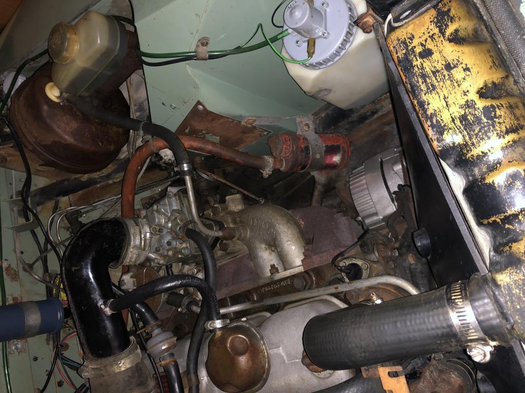

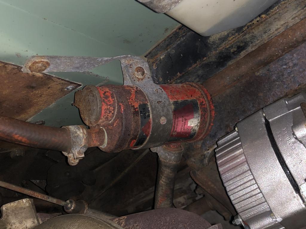

          @roverp480, Yes, quite interesting. I too didn’t know the US had dedicated engine numbering. It’s in line with the extra emissions items mine has… fuel vapor evaporation tank below driver’s side, charcoal canister and pcv valve beneath the hood, along with one other red canister/filter? (pic attached, sorry host rotated them) in the heater hose line. So would such a ‘307’ 88” be considered a NADA model?
          On the valve stem topic, I’m hoping if I’m able to replace them via valve cover removal that the blue exhaust smoke seen on cold or warm start-ups, and pull aways from stop lights, will go away… vs needing to do a ring job. Is that what lead you to do your valve stem seals too?
