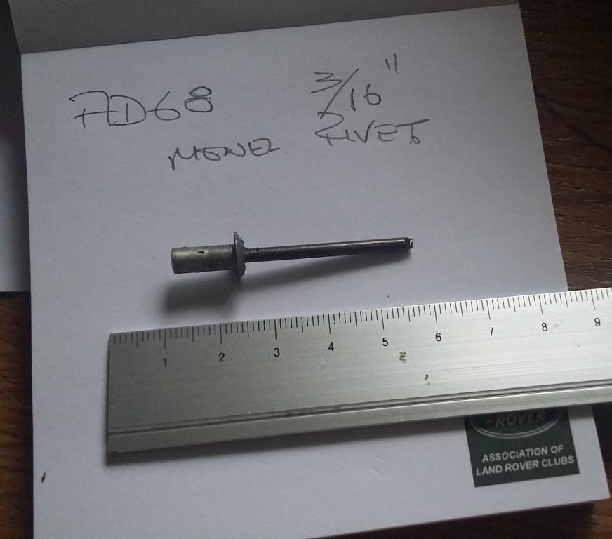

        #4
        Sealed Rivet for Metal lock on 2A door window . Picture below
