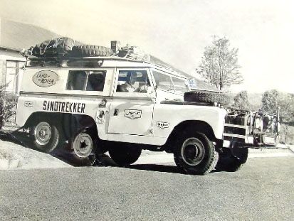

        The Vehicle I refer was Called Sandtrekker and definitely used a modified transfer box with two outputs. One drive shaft went straight to the front of the two rear axles and a second was a divided shaft with centre bearing on top of the first axle . Hardy Spicer who made the drive shafts, advised that the working angles would be well outside their design limits but did help with making them. I gather it worked well on the expedition. It had manual free wheel hubs on the rear axle to prevent scrub on hard surfaces.
        I was present when the crew gave the Midland Rover Owners Club ,a presentation about it , when they returned.

          #5
          WOW!!!!!!!!!!!! thx, p480. looking at the photo it is a fair distance from the top of the intermediate diff to the rear one. I wonder how far spicer figured the angle was "out of specification" ? There are other rigs out there and now i think it must be the same sort of arrangement. pa blanchard has some i think for sale. I've yet to get the mirrors for my s3 from them. I don't have any idea what they cost and pa blanchard didn't reply with a us price. i guess i'll google it but so far i never found a order page on their web site but totally doable i'm sure.

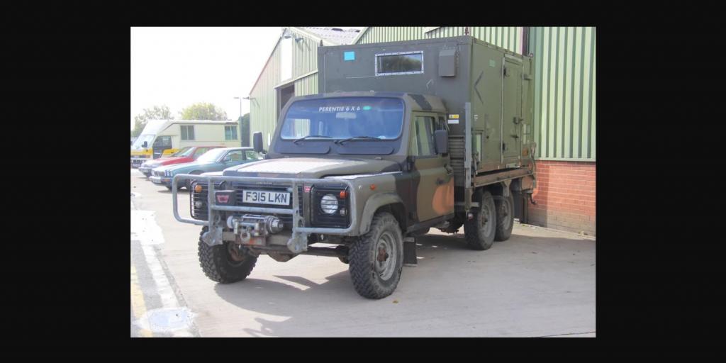

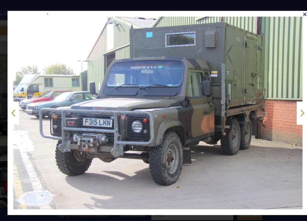

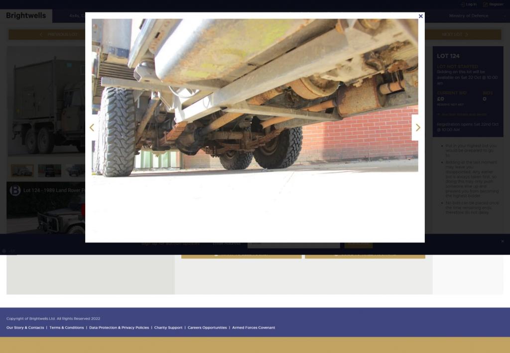

                Another 6x6 based on Land Rover from Australia . The drive to second rear axle passes over the top of the firstClick image for larger version

                  thx 480, I can see how that works now. i'd like to see those axles with one on a curb and the other in a depression. If spicer said they were "way outside their limits" i wonder what it looks like? i know some farm machinery will make a 'bend' further than anyone will expect. evidently it works good otherwise it just wouldn't be done.
                  now then!, where do we get those transfer cases??
