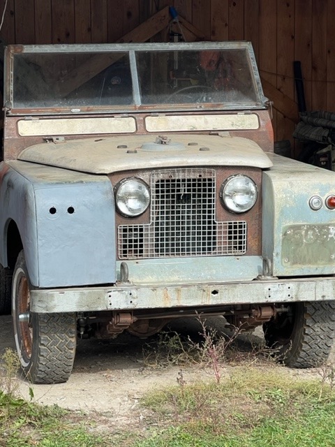

    My 64 Diesel 88 project (my father's rover) was on hold for over ten years when life became too complicated. We are both a little worse for wear, but it is back on track with the help of a skilled mechanic and new friend. I couldn't be more pleased.
    There is still plenty to do, but I have begun reassembling the rover. A very simple question:
