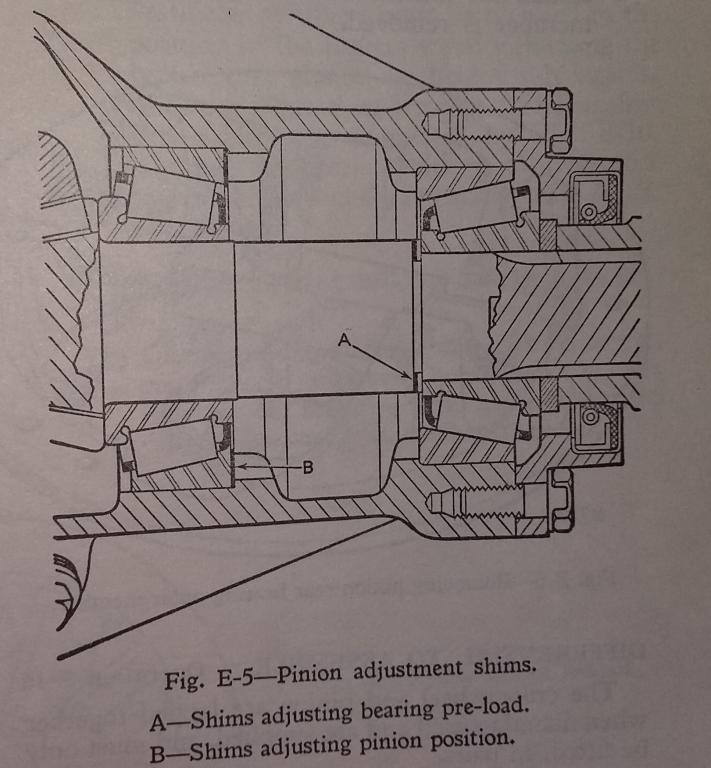

    The pinion has two bearings, and you need the differential out of the axle to work on it as the inner bearing is only accessible from the inside. Is the existing pinion actually loose or notchy , as I have usually found wear in the universal joints is a more common reason for vibration. ? The picture shows the two bearings. This is the early version with the oil seal in a separate end cap, later ones have the seal directly in the iron diff. housing .

      I had hoped to not have to disassemble the front end again. Just finished replacing the swivels and have the engine reinstalled after the rebuild…😫. It’s definitely the pinion causing the vibration. It seems to have quite a bit of wobble at the flange with the driveshaft removed… Thank you for the diagram and input.
