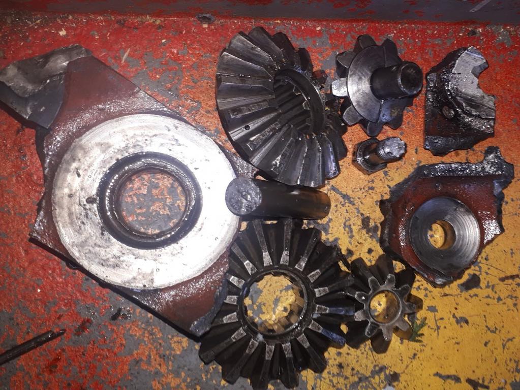

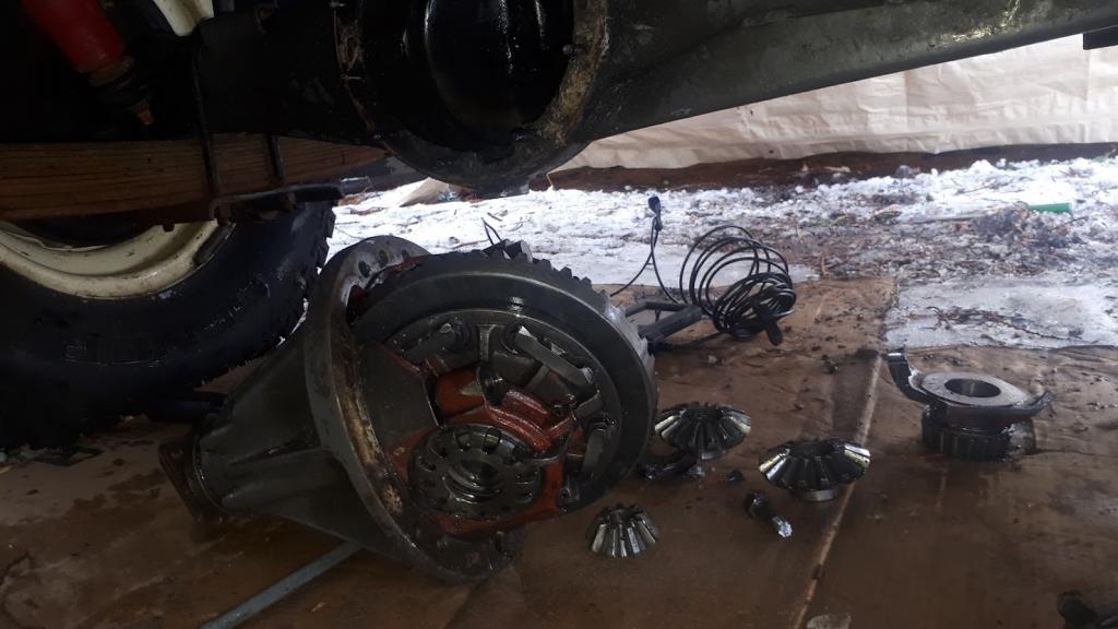

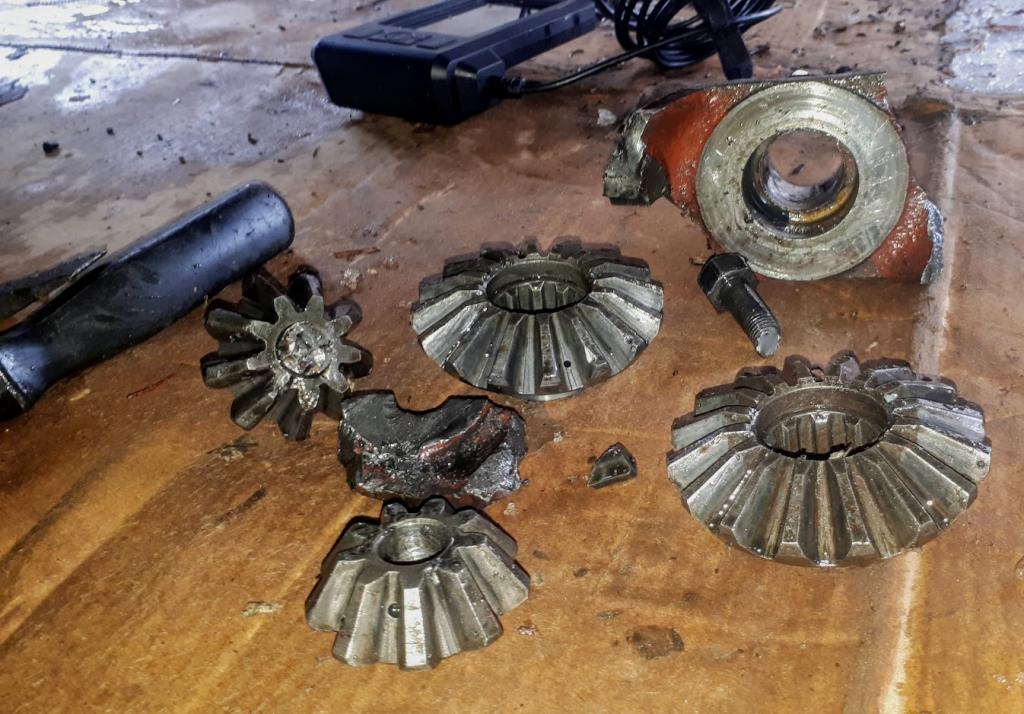

    Im in need of a rear diff with 10 spline axles. Any advice on where to find one?
    Also what is your opinion of driving the lr with just the front diff with rear axles removed. Are the rear wheel bearings lubed from the diff oil?

    Took me hours to pry it out of the housing.
    My head ached for two days.
