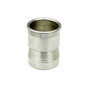

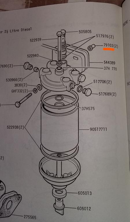

    I am certain the bolts screw into thread inserts (Rover Part 79103 Nutsert 5/16 UNF ) which compress and expand with a tool to grip the panel . I had them loose on my S3, The trouble is that once loose it is difficult to get the bolts undone as the inserts just turn in the panel & you cannot get behind to hold them . I got mine undone by driving a screwdriver as a wedge between the housing and the panel to jam the insert in the hole and carefully undo the bolt. I then reinforced the area with a plate pop riveted to the panel with new inserts in it ,
