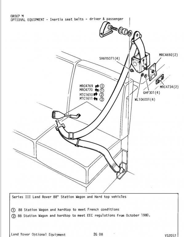

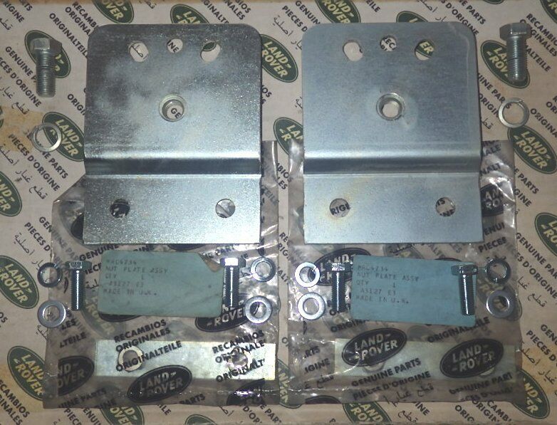

              I am not sure if these parts are still available but this is what I used on my last S3 back in the 1980's. It allows the reel to fit to the rear tub capping on 88" vehicles . The belt reel was designed to fit tilted forward at an angle so the belt webbing had a strait run to the upper anchorage.
Name:	Web capture_15-11-2023_17137_.jpg
              This shows the actual parts which I am sure could be reproduced - Click image for larger version
                  [ATTACH=CONFIG]14447[/ATTACH]
                  This shows the actual parts which I am sure could be reproduced - [ATTACH=CONFIG]14448[/ATTACH]
                  I like that, thank you.. I should have looked at my parts book too.
