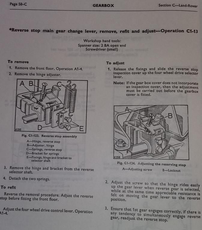

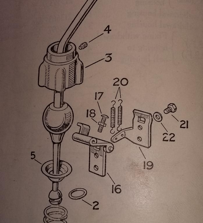

    #2
    The mechanism is external to the box so cannot fall inside the case. The reverse stop is a spring loaded flap that is bolted to the reverse selector shaft outside the main box . One of two things are most likely to have failed. The flap has a threaded adjuster which could have come loose and that allows the springs to come loose & fall out or the springs may have failed . You can just about get at it without taking the floor or tunnel out through the plate on the side where the yellow 4x4 knob/shaft goes. Unscrew the yellow knob, & take off the spring underneath and then remove the plate where the rod goes through. The screws go into a captive nut so there is nothing to fall underneath . You then can just access the flap mechanism to either adjust the stop or replace the two springs . I had it happen on mine and was able to rectify it at the side of the road . It is a fiddle get at through the side plate & if you can take the tunnel cover off it will be a lot easier . I would add, the springs if loose can fall into the selectors and prevent one engaging a gear, which doesn't cause any damage just awkward to drive!
