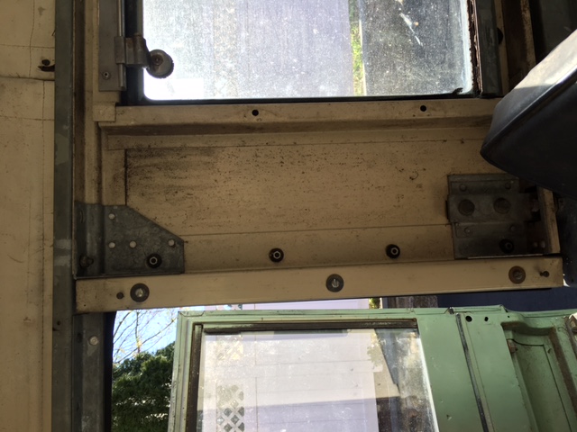

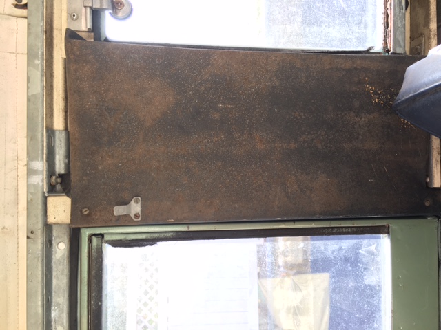

    My passenger has requested shoulder belts. I don't know if this is a commentary on my driving or that of my neighbors, but I figure it couldn't hurt. But I don't want to do major surgery on my truck. So my question is what is the minimum I need to do. It's a hardtop, 2A, 88". Here are photos of the door pillar, with and without the cover. It doesn't have a rollbar or anything like that.

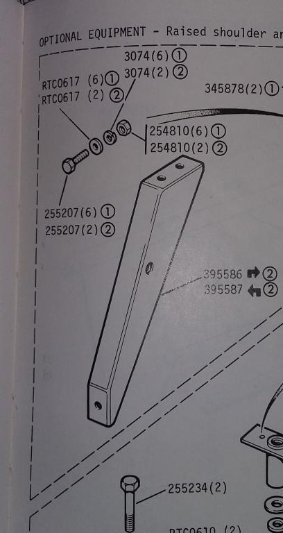

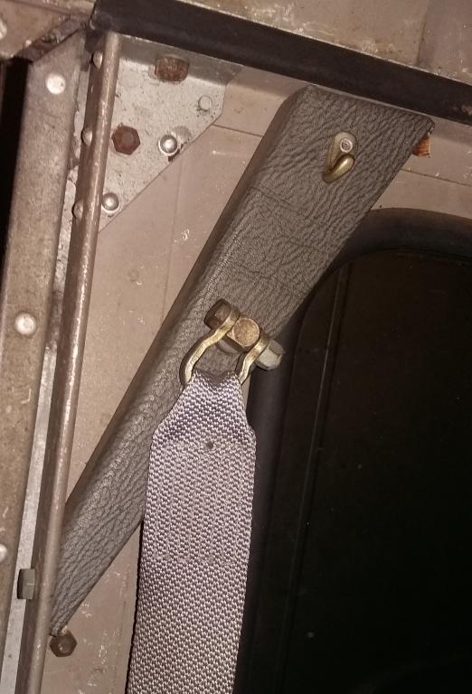

    The easiest way is to fit the anchorages that were optional on S2/3 . The part numbers were 395586 & 395587 ( Now ADU710110 & ADU710100 - Our hosts list these ) . There are a number of later anchorage plates fitted to later S3 and early 90/Defender that had provision for inertia reel belts . Photo from 2A/3 parts book and them fitted to my S1 SW . Exmore trim also supply their equivalent to 395586/7

        on your photo 2a, that 2nd bolt down is where i believe my oem shoulder belt hookes to. the one that is at the same elevation as where the belt is hooked on p480's photo.
        where it hooks on the bottom is another matter for even the factory one on my S3 has a indentation in the seat panel that no doubt isn't there on the S2. I've never looked at what it hooks to on the other side of the panels. right or left side, besides, i took them out as it hardly ever goes on the highway and when i take the top off they can't be used anyway.
