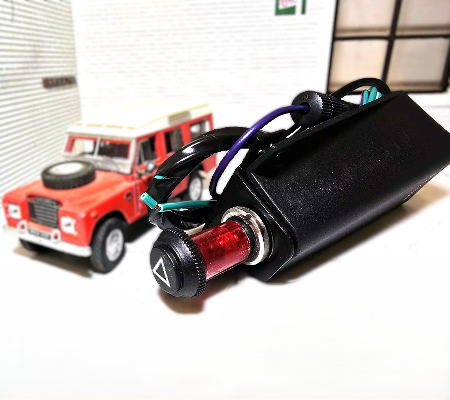

        Here you go:
        I have one of these. I bought it before I figured out the above method. It has the flasher unit built into it, so it's a little bulky. I'd sell you mine if I can find it. Let me know and I'll look if you want. Would be quicker (and cheaper) than shipping from England.

          The Emberton one contains the basic parts that LR used on the S3 4 way flashers . It means, if you have the space you can discard the plastic housing and mount the parts individually with the switch in a suitable panel . Also its independent of battery polarity

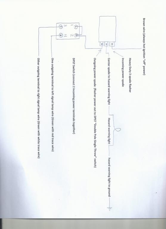

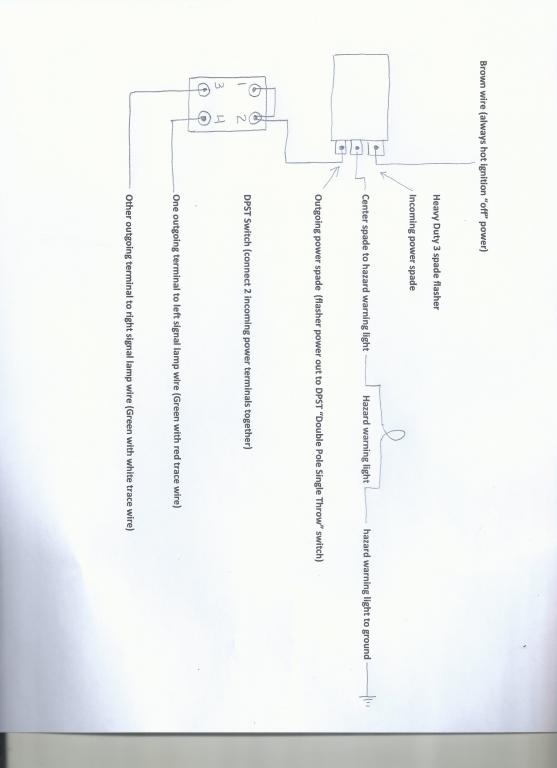

            The problem with a hazard warning switch is the need to have the two turn signal circuits disconnected when the switch is ‘off’ but connected when ‘on’. This can be simply done using a DPST Double Pole Single Throw ON-OFF toggle switch. I’ve yet to find a Lucas paddle handle toggle switch with this configuration, but one likely exists somewhere. The normal silver handle toggle switches in the DPST configuration are easily found, if you don’t mind a different looking switch. A typical DPST switch has four terminals or spades, with two inputs and two outputs. Call these #1 and #2 on the input, and #3 and #4 on the outputs. When the switch is ‘ON’ the #1 input is connected to the #3 output, and the #2 input is connected to the #4 output , but #1 and #2 or #3 and #4 do not connect. For this hazard flasher circuit, you will need to connect #1 and #2 together.
            As already discussed, power should be from the Brown wire always hot circuit so the flashers work when the ignition is ‘off’. You can install a fuse if wanted. If you want a dash hazard warning lamp a three prong or spade heavy duty flasher will be needed. The incoming power will be connected to the input spade on the heavy duty three prong flasher. Typically the center spade on the flasher is for the warning lamp, and the wire to the lamp is connected to this spade. The lamp will need to be grounded, and I try to use a two wire bulb socket rather than grounding at the socket itself. The third spade on the flasher is the output and will need to be connected to the input side of the DPST switch. If you don’t want or care about a dash warning lamp, then a heavy duty two prong flasher can be used and ignore the warning lamp bits.
            On the DPST switch, run a jumper from the one input terminal to the second input terminal to tie the inputs together. One output terminal on the switch will need to be connected to the left side turn signal Green with red trace wire. The other output terminal will need to be connected to the right side turn signal Green with white trace wire.
            Power will always be routed to the hazard flasher but with the DPST switch ‘off’ no power is routed out to the turn signal lamps, which are isolated from right and left in the switch. When the DPST switch is ‘ON’ power is routed thru the flasher to both switch inputs and to each output, so all four turn signals light up. When the flasher contacts open, the turn signals go out….. repeat. If you use the dash warning lamp type of flasher, it only lights when the turn signals do. Sorry for the way the drawing loaded.
            Bob
Name:	Simple Hazard Circuit.jpg
