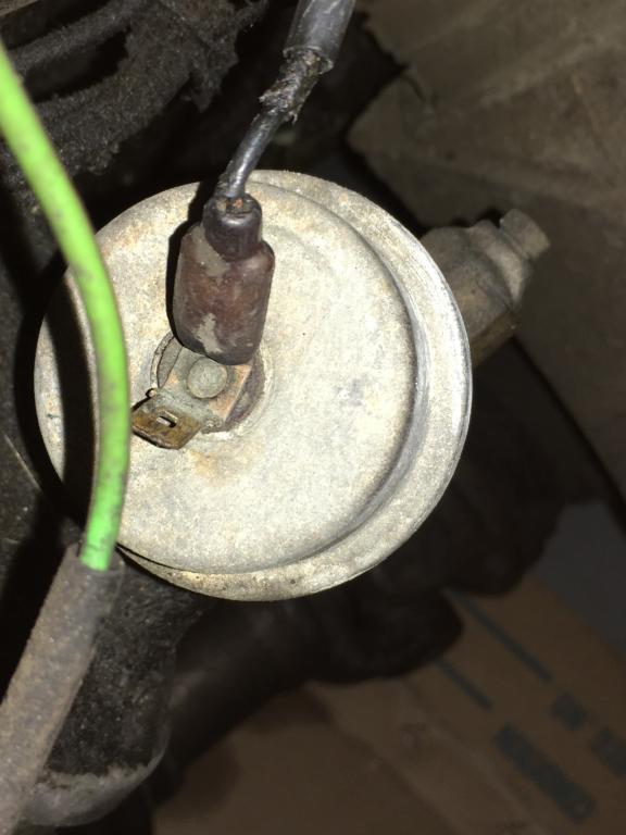

      Here's a photo after I removed one of the wires. It's in the foreground - light green with a brown tracer. That's the one running to the gauge.Click image for larger version

        Certainly looks like a 537138 sender so I have no idea what the other loose wire is doing . I have a wiring diagram from a One Ten LR & that circuit just shows the light green/ brown wire connected to one of the blades on the sender with no other connections, as said it completes the circuit throw the body of the sender . I may be worth checking the sender to see if it isn't open circuit

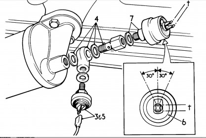

            The thread is a standard RH so counter clockwise to unscrew. It only about 3/8" dia so should unscrew with a spanner on the hexagon without too much force. As you can see in the attached picture of the parts list, which may help you understand the assembly , the sender screws into an adaptor .

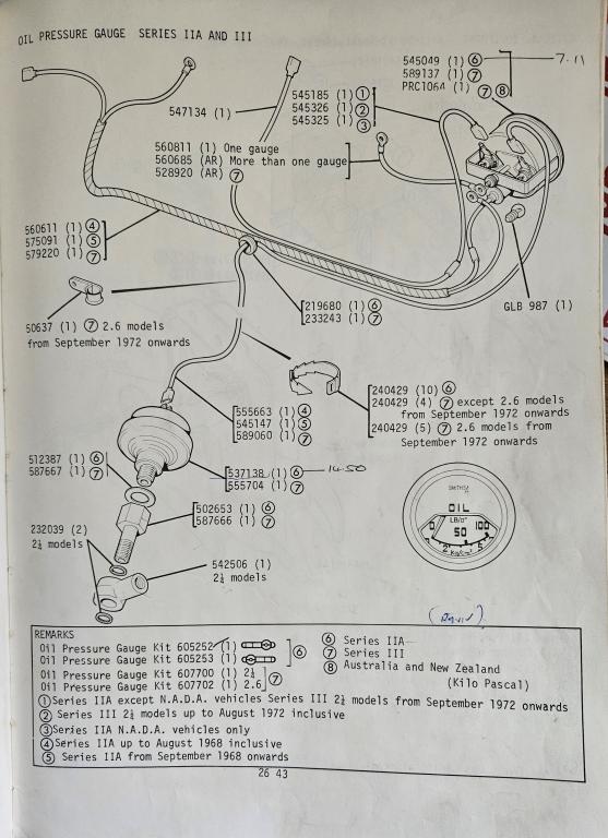

              Thanks for the diagram - very helpful. Where did you find it?

                Series 2A/3 Optional equipment catalogue. There are a lot of items fitted to Land Rovers that are standard in some markets but are only listed in the Optional equipment catalogue , such a S3 steering column locks. For info N.A.D.A. is North America Dollar Area

                  The oil pressure sender is a complicated device, and needs to be installed in a specific way to function correctly. The oil pressure gauge and sender do not use the power supplied by the instrument voltage stabilizer, unlike the fuel and temp gauges, as the power is supplied directly from the fused 'green' circuit. The same type of sender was used on various other English cars and there are several different pressure spans and thread types so not all interchange. If keeping an electric oil pressure gauge have typically replaced the gauge and sender with ones made by VDO.
                  Looking at your picture, the black wire on your sender is connected to one of the two spades on the same riveted connection. It won't be a ground as that would ground the gauge power circuit.

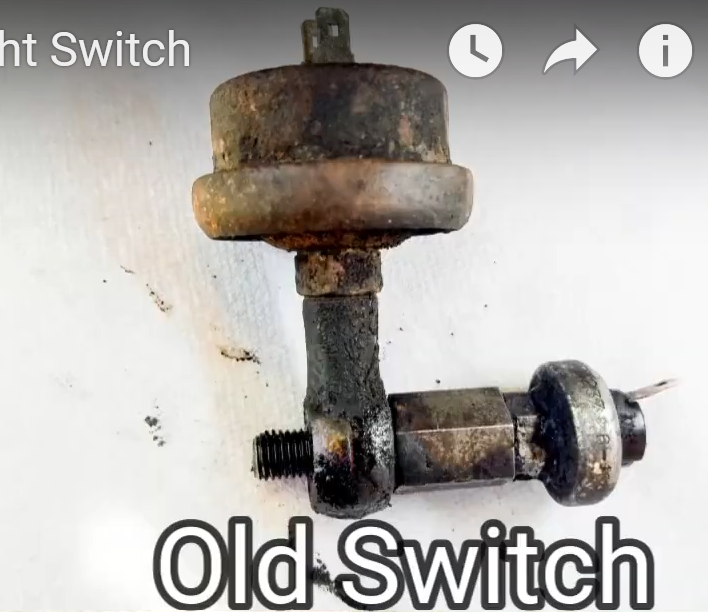

                    Thanks. I guess my next step is to figure out how to connect the gauge to the fused circuit. In the meantime, I managed to remove the sender. I think the pressure switch for the oil warning light is missing. Mine looks like this from the web:
Name:	Oil pressure sender and switch for green light (another).png

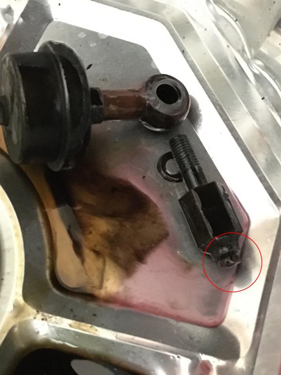

                    But instead of the switch with the single terminal on the right, there's a small bolt head there. Is that where the switch should go? Maybe someone removed it and stuck the bolt in to seal it? Here's mine. The mystery bolt is circled.

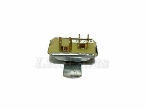

                      Yes, the oil pressure switch should be where the bolt is located. The low oil pressure light is powered a white unfused ignition on power wire and from the light a white with yellow tracer or white with brown tracer wire goes to the switch.
                      I think on your truck the fusebox is under the bonnet. There should be a green wire from the fusebox running to the instrument voltage stabilizer, typically located on the rear of the speedometer. There are two male spade connectors on the stabilizer, and the green wire from the fusebox connects to one of these spades. It is likely the green wire for the oil pressure gauge was originally connected to the other male spade on the stabilizer. The two female spade connectors on ths stabilizer are the outputs and supply the nominal 10v to the temp and fuel gauges. Note that some aftermarket stabilizers have a male and female spade on each connection point, but the originals have male spades on the input and female spades on the output. The stabilizer looks like this:
Name:	Instrument voltage stabilizer.jpg
                      Bob
