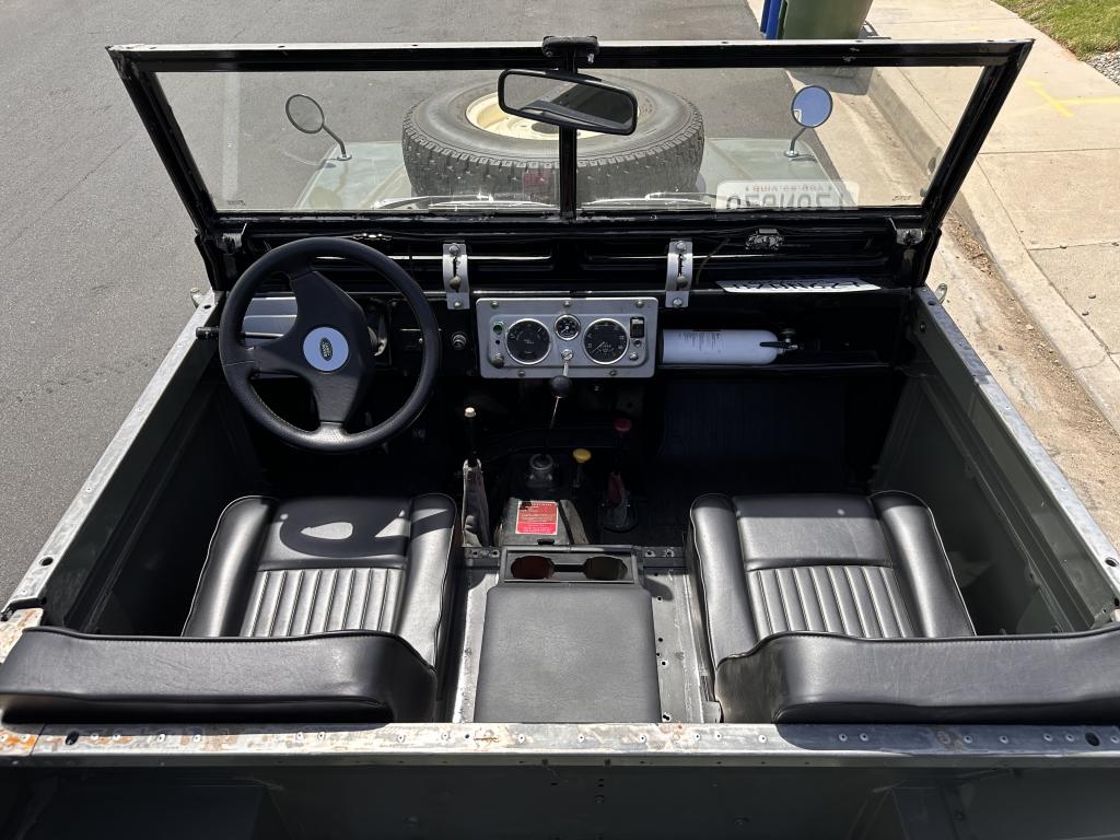

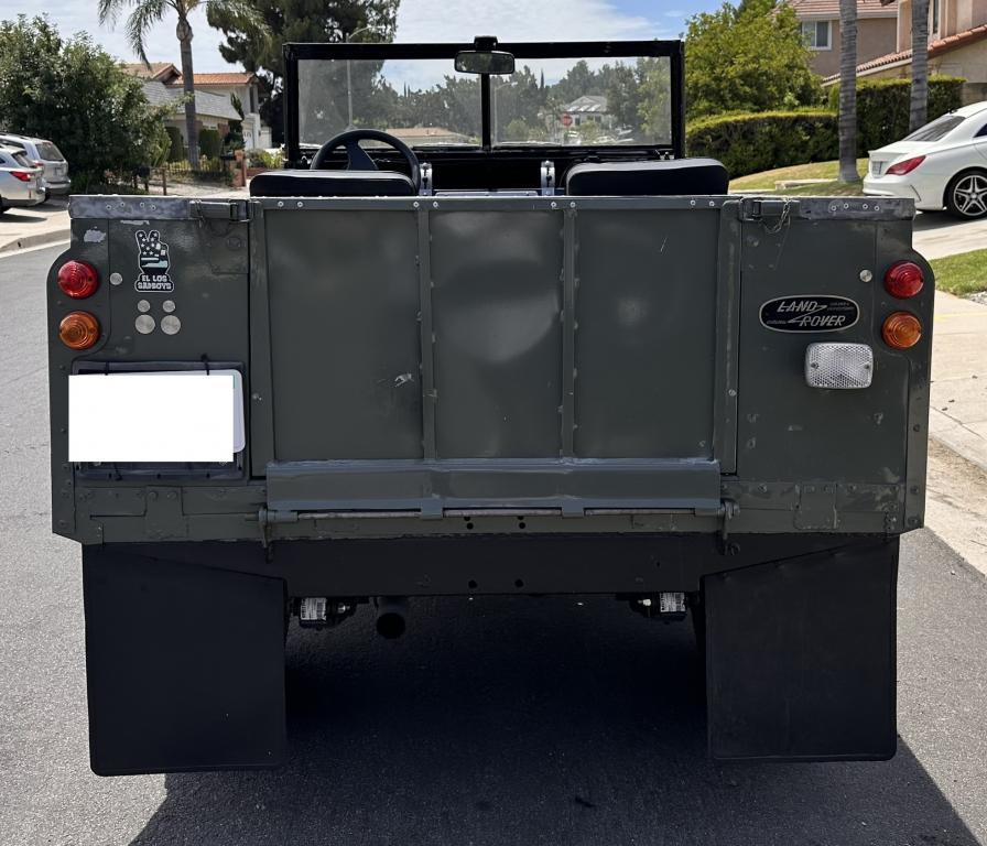

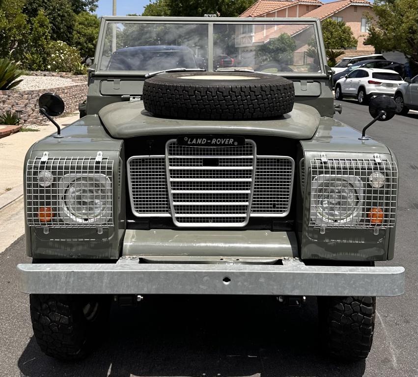

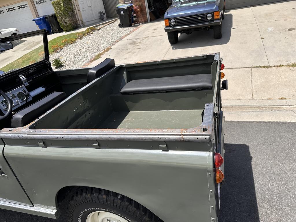

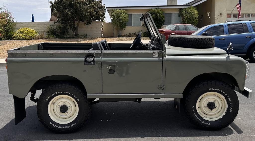

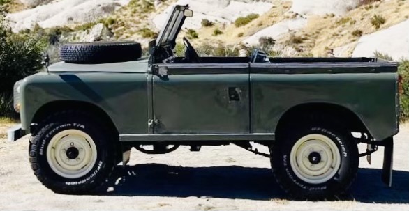

    I recently picked up my ‘71 Series IIA 2.25ltr Diesel and absolutely love it; I’ve always wanted a Series and although I do not plan to do a full original restoration project, I would like to keep it period correct in appearance. I will add some modern reliability and performance in some areas such as the RoamerDrive, wiring reliability (its in pretty good shape, but has some add-ons that don’t go anywhere), and maybe get a set of steelies that I can put some AT Tires on for daily driving to and from my beach runs and hangar.
    It has new brakes, new suspension, appears to be nearly rust free, but does have character dings/dents that I love about it. Partially new interior components that are all aftermarket repops and appears to have all come from Rovers North. I do have the center seat as well but it currently has a center console that works perfectly for some small storage.
    On that note, I am completely new to Series Rovers; I have a ton of experience in more modern Rovers such as Discos and LR3/4 but almost zero in Series; I feel I am in the right place to learn.
    One place I would Iike to start is to get a bit of history behind it, starting with the ID Tag Number so I can see what I have and what is going to fit. I believe it is a prior military IIA so it has some of the IIA and some of the III parts which makes it complicated for me to ensure what to order when I do repairs and upgrades. I have two hard tops for it (one Safari), door tops without sliders (would like sliders), and rear sides w/sliders that I want to rebuild and reseal as we get ready for the cooler winter months. I do not have a rear door and would like the top for my tail-gate and maybe get a full rear door at some point.
    Here is the ID Number: 323014266

    Any help for ID/VIN search spots and recommendations would be greatly appreciated!

    The ID seems slightly odd , should finish with a letter not a number, perhaps you have mis read it . The initial 323 shows it as a LH steering export 88" 2A Diesel Station Wagon , the sequence started with 32300001B . This info is from the Land Rover S2A parts catalogue . Where did the ID number come from and is it stamped on a plate or the chassis . ?
    If you want confirmation you can email the British motor museum which hold the dispatch records . One can ask one question or get a certificate with all the details they hold. I would advise that the Rover records are not very comprehensive and usually only confirm the model, date of despatch and its destination. Often it wont list colors etc. British Motor Museum | Information Services
    I have just looked on the LR Series Two club website and the last digit could well be a G not a 6

      I wish mine looked as nice, for a 71 the dash layout throws me as I wonder if it's a Santana?

        Quite possible the frame ID is a G and has been misread by me and all the way back to it's import days. All the paperwork I have, including the papers from Yugoslavia, shows the number I posted above. My Cali title and registration and all previous registrations and import docs say the same, too, so I don't think I want to open that can of worms with the DMV..hahaha
        On that note, I'll get under the chassis, clean it up, and see if I can find a better number to confirm; are frames stamped in more places than one like in the U.S.? If it is a nine-digit ID convention, then I would assume you are quite possibly correct that it has been a misread and has followed it through its U.S. import life back to 2012.
        The previous owner did say the dash panels are not period correct, as he bought the panels from eBay a while back and plugged in the existing gauges and switches where he could.
        How would I know if it is an LR or a Santana? Does Santana have a different ID convention since you say the first three show 323 LH Steering export 88 2A Diesel Station Wagon; is your assumption that it's a Land Rover build?
