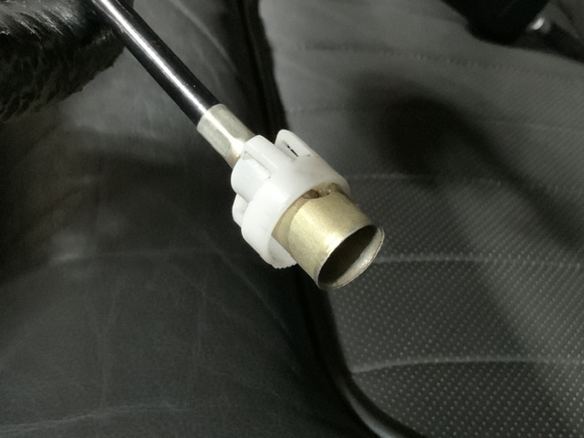

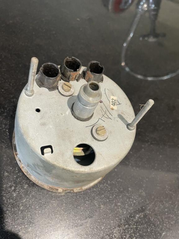

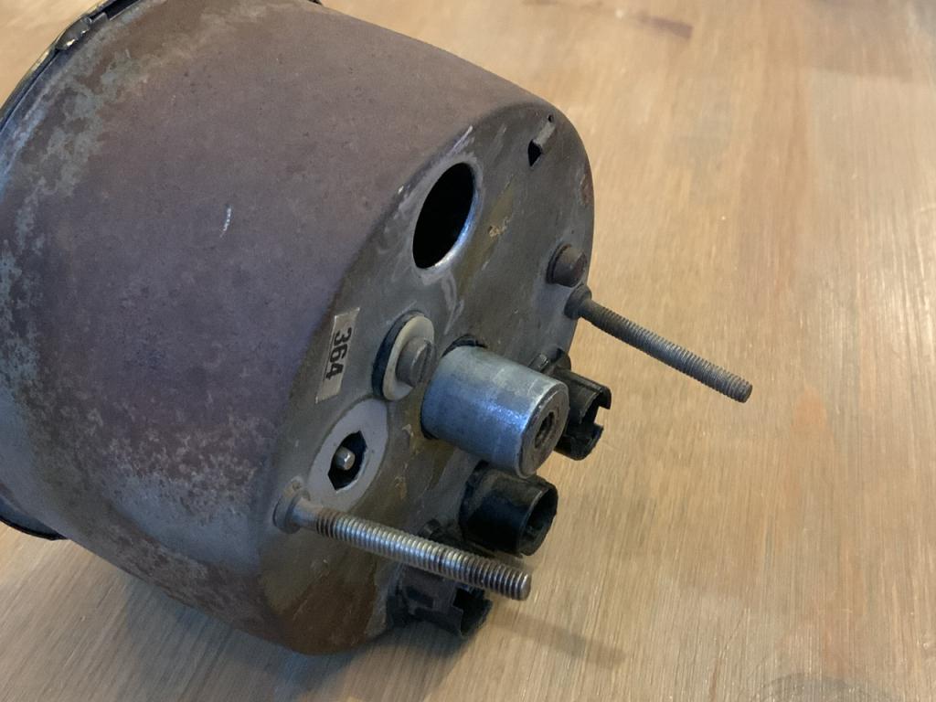

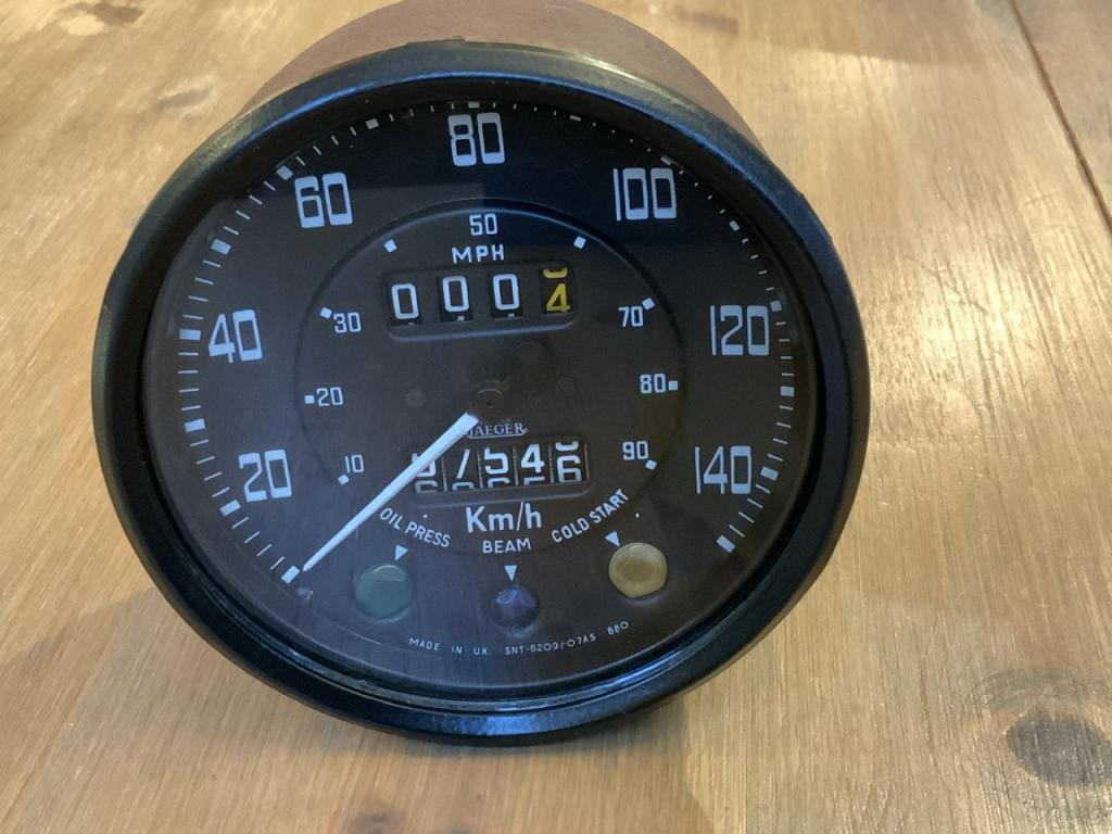

    Hi all, my speedo has not worked since I bought my 1975 SIII 109. Finally had some time to take the dash apart and investigate, and I found the cable and speedo are not matched. Basically I have what appears to be a SIII clip-on type cable, but the back of my speedo does not have a machine-notch to accept the plastic clip on the speedo cable - so the cable pulls right off the back of the speedo. I understand the SIII cables use a plastic clip, and the II/IIA cables had a threaded end on the cable. My speedo appears to not be set up to accept either cable type. My speedo is not threaded nor does it have the machined-notch to catch the plastic cable end from sliding off the speedo. It’s a jaeger gauge, SNT - 6209/07AS 880
    I will post pics of everything, and I’m wondering do I have the wrong speedo cable, or the wrong speedo gauge? I took the gauge apart, cleaned everything, found a cracked 20-teeth gear which I plan to replace, but overall the speedo gauge works. I’ve been testing it with a drill and it works fine. The speedo cable also works as I’ve driven around town and watched the cable spin around as I drive.
    I’m hoping I can replace the cable with the correct cable for this speedo. Rather spend $30 on a cable rather than $350 on a new speedo.

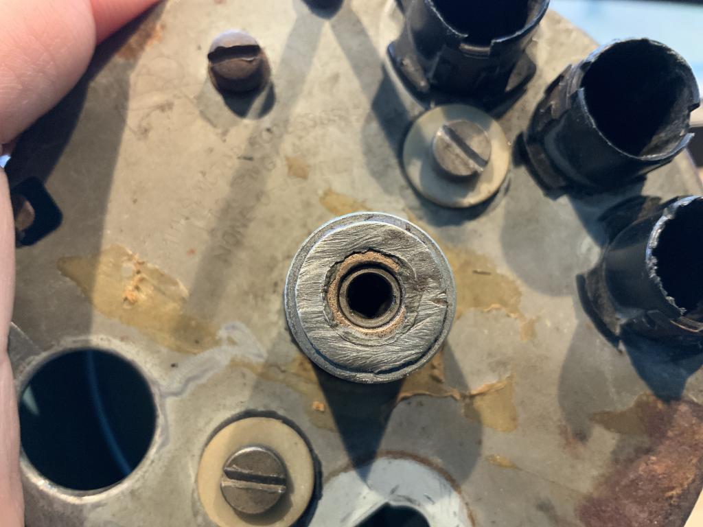

    I have never seen a connection like that. This is the back of a standard S3 fitting. I wonder if yours has actually broken off . Could you make some sort of sleeve to connect the cable or put a split the sleeve on the cable and then attach it with a small hose clamp to grip the existing stub. Just make sure the inner cable puts no end load on the innards of the speedometer I notice yours is a km version

      that's not a usa guage as the us models have the mph as main display and kph on the 'inside' so your cable with the clip does fit a S3 as I've replaced mine a couple times but the guage assy is different and for some place that has kph road signs!!

        Thanks for the replies! Yes, I realize it’s not a U.S.A. gauge, truck was imported from Africa. Roverp480, I think you are correct - upon closer inspection it appears the back connection has been sheared off - when I look under magnification it looks to have been cut off (see zoomed in pic). I like your idea of a hose clamp - that may hold things in place. I will test run with a hose clamp before putting everything back together. If successful, I have to order a new 20 tooth gear for inside the speedo - $35 shipped for a plastic gear that is smaller than my pinky fingernail! Thanks again.Click image for larger version

          unclear how far it sticks out above the instrument cluster but you'll probably want to cut a piece of rubber to put around it under the clamp before you tighten it up, it you have some overlap and a small but wide clamp then it'll probably hold
