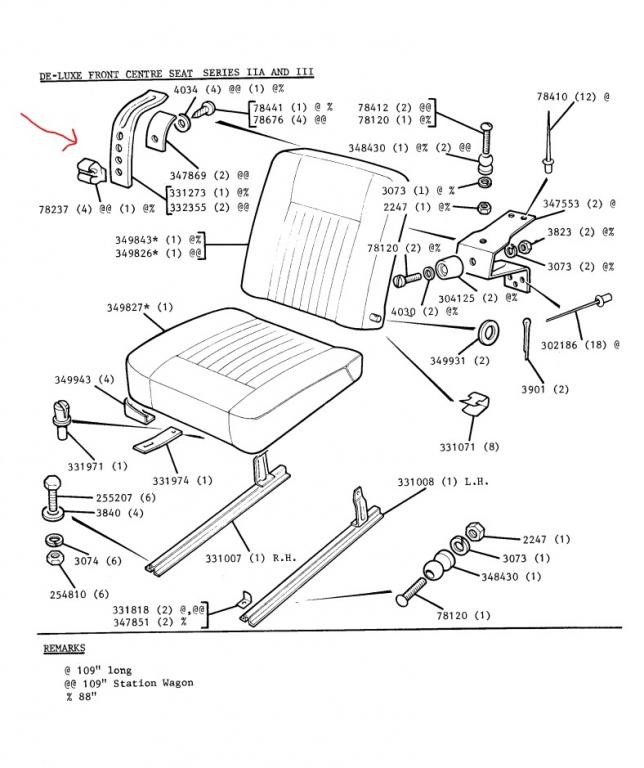

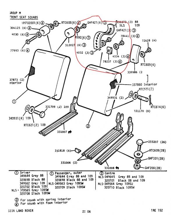

      It appears this was an option. I’ve already purchased the leather straps and installed the studs on the bulkhead behind the seats. I’ve seen pics of other series that have them installed. The reason I found them is my passenger seat falls forward when I drive down my steep driveway. I thought there might be a solution so I started researching. They are listed in the parts catalogue and RN carries them as well as others.
      I have original deluxe seats and the seat backs are made of Masonite. It looks like a rectangular hole is cut to accept the spring tabbed spire nut which will accept the screw that secures the leather strap.
      Cheers

        Is this of any assistance
Name:	Web capture_21-11-2023_9417_.jpg
        Or with metal backed seats
Name:	Web capture_21-11-2023_9927_www.series2club.co.uk.jpg

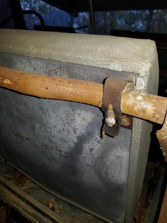

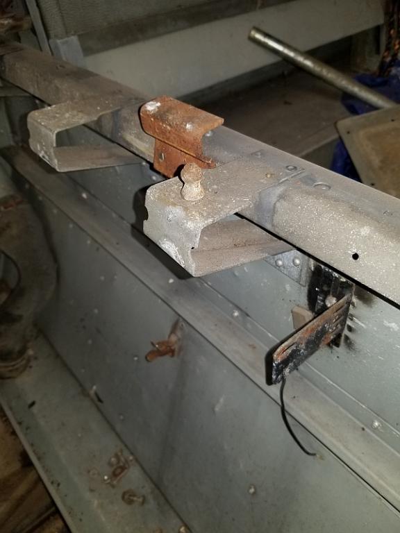

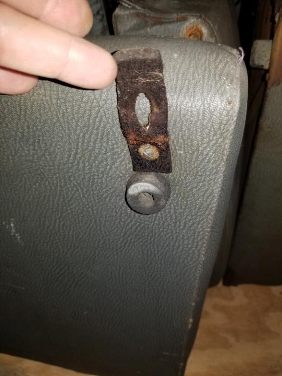

          #5
          There most definitely are seat straps. The 109 SW straps fasten around the bar to a metal post. The 109 2 door and 88's fasten to the rear bulkhead on a metal post (both types show below). Some seats have two straps, others just one. One is all you need. Make sure to measure the distance to the post and test fit it (if possible) before screwing it into the seat back. There is the leather strap, and a rubber bumper pad. The pad differs slightly between the two types.
Name:	Seat back strap 109SW.jpg
Name:	Seat back strap 109 2door_1.jpg
Name:	Seat back strap 109 2door_2.jpg

            #6
            Yes, I bought the parts from the first diagram. Looks like I have to cut a square hole in the Masonite panel on the seat back to accept that spire nut. One chance to get it right so I’ll measure twice and hopefully cut once😜
            Thanks for the info and pics!

              #7
              These are screwed directly into the seat backs on the originals. I don't think you need the spire nut. They aren't holding much force. I'd try that first.
