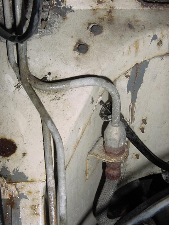

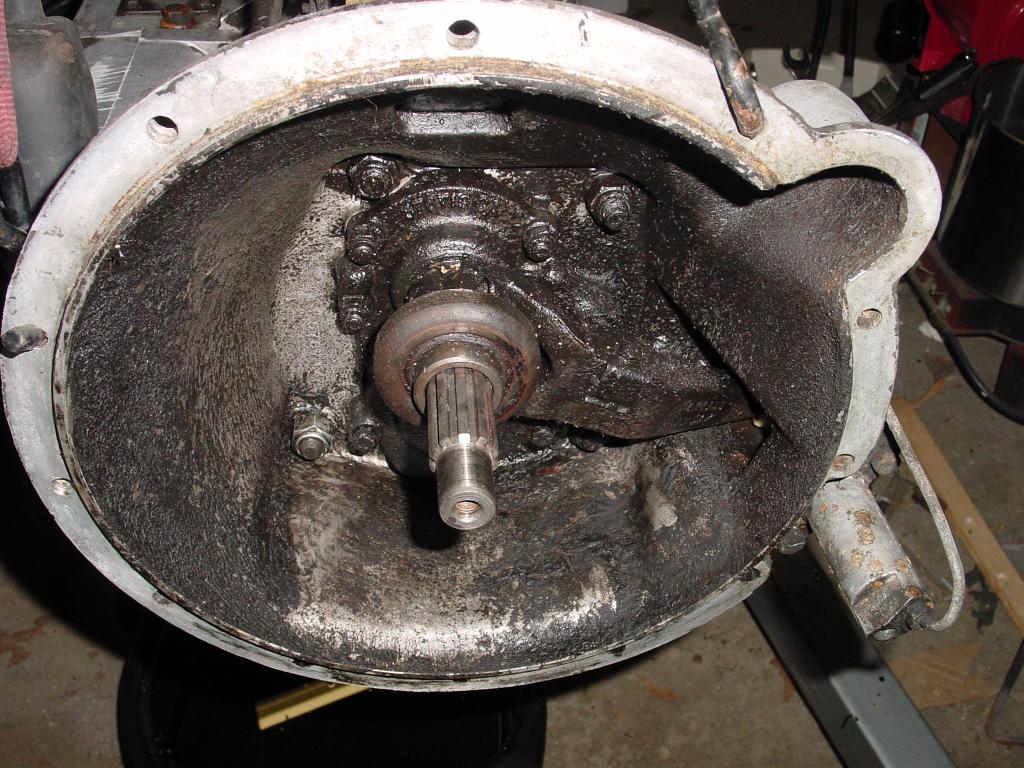

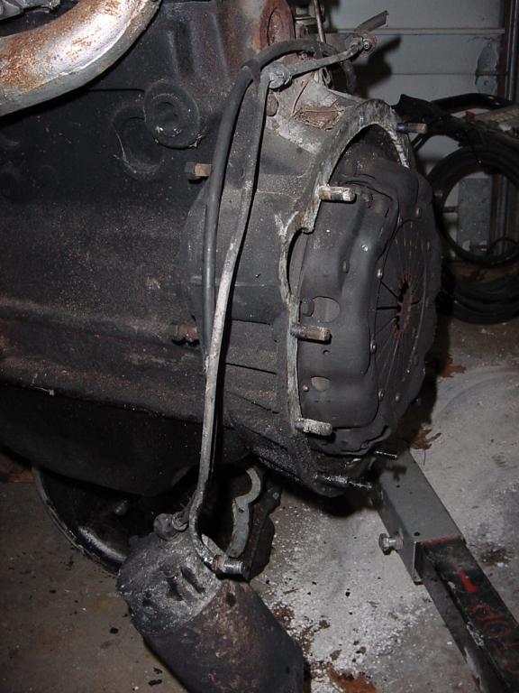

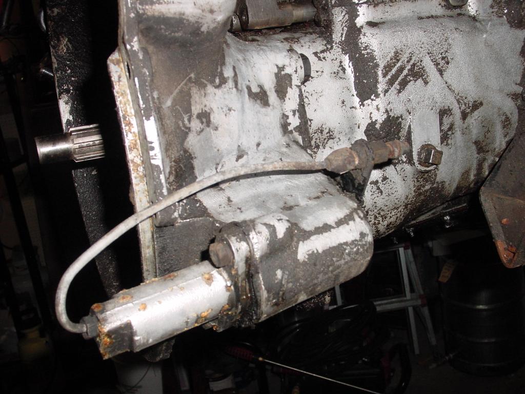

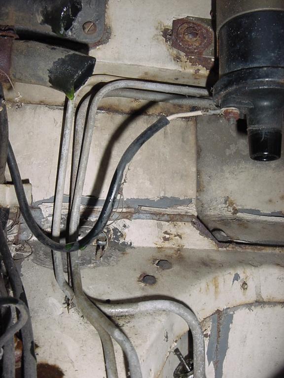

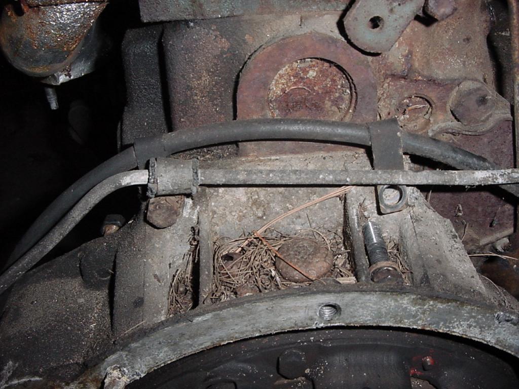

    Hello Forum-
    I'm replacing my sieve of a slave cylinder and while I'm at it, replacing all of the hydraulic lines back to the original routing. Currently, the clutch hydraulic pipe comes off the master, and drops straight down (dangles freely) to connect up with the slave. Proper routing for a Series III LHD is to exit the master into a pipe that runs along the bulkhead, drops down into the flex line which is anchored to the bulkhead, then a third line that exits the flex and mates up to the slave.
    Does anyone have any real pictures to share that shows the correct routing of the pipe that exits the flex line and connects into the slave? The part number is NRC3287. If this routes up over the back of the engine, my concern is that the pipe will be close to the engine and be exposed to engine heat, especially in the summer? Should this be a concern? I have been unable to locate any pics on the internet of what the correct routing of this pipe looks like.
    THANKS!
    -Ben

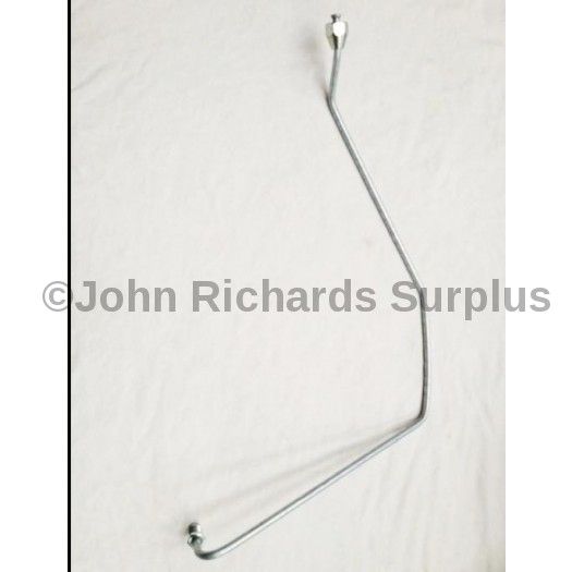

    Not sure if this helps but this is the shape of the pipe . Click image for larger version

      Originally posted by roverp480
      Not sure if this helps but this is the shape of the pipe . [ATTACH=CONFIG]14458[/ATTACH]
      Thank you for the picture. That's exactly the pipe I have. Is the proper routing of this pipe up over the backside of the engine flywheel area?

        #4

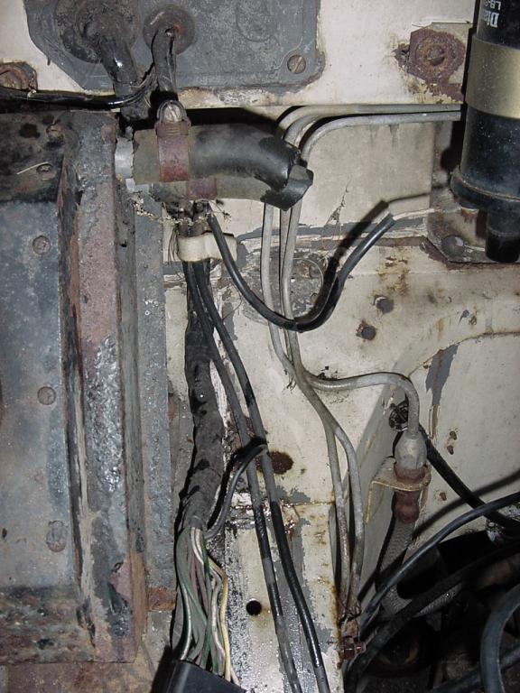

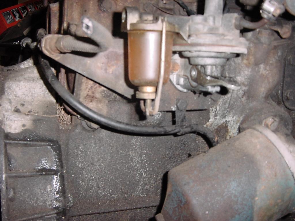

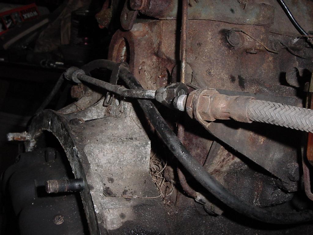

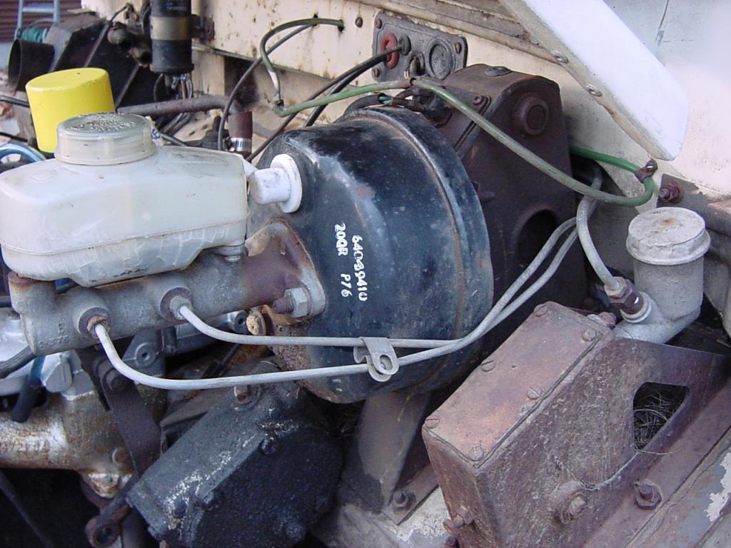

        Here you go, tear down pics of a NAS 73 ser III 88 , Talbot

          left/right drive
          [ATTACH=CONFIG]14459[/ATTACH][ATTACH=CONFIG]14460[/ATTACH][ATTACH=CONFIG]14461[/ATTACH][ATTACH=CONFIG]14462[/ATTACH]
          these pics are of the clutch on the same side as the exhaust manifold and fuel pump. that's a RH drive right?

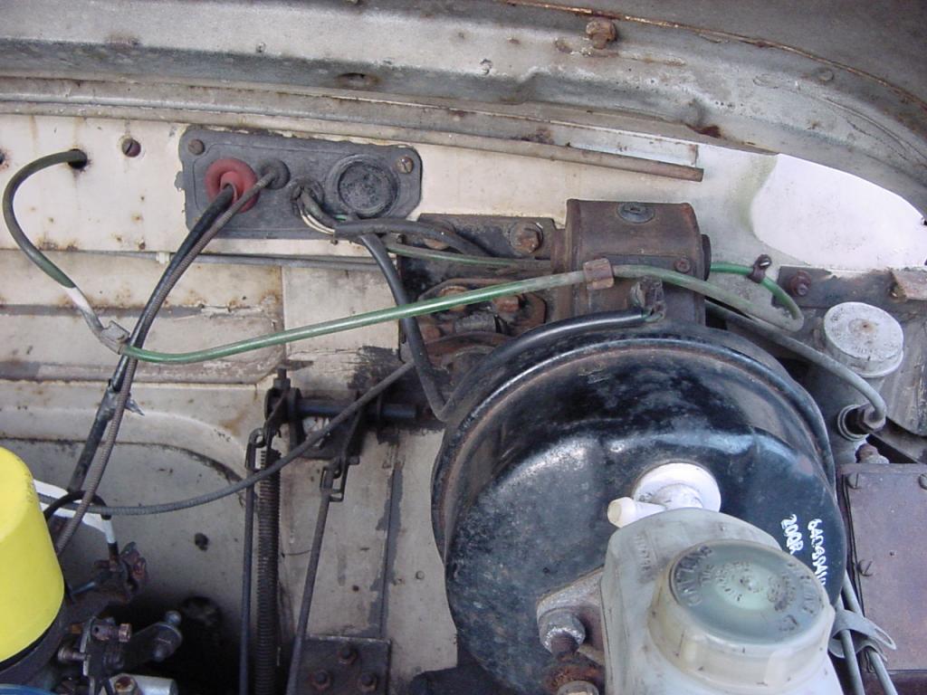

            Not a RHD model ..Pics are from a LHD NAS 88 Ser III 2.25L petrol
            More pics from the same teardown , clutch piping runs across the bulkhead with some brake lines

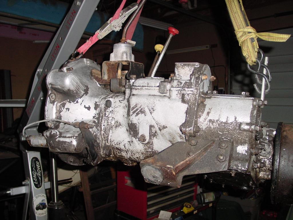

              Ser III clutch slave cyl.Click image for larger version

              • westbound
                Low Range
                • May 2023
                • 17
                #8
                Talbot, thank you very much! These pics are exactly what I needed to see - very helpful!
                Happy New Year!
                Ben
