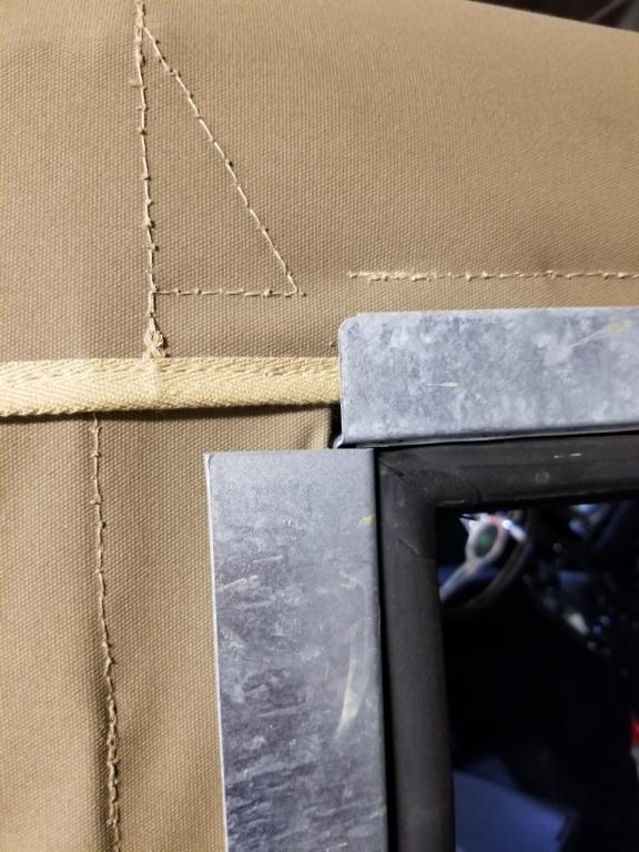

    I noticed the frame for my soft top has little flaps of metal above the slotted rail where the vertical portion meets the sides of the soft top. Am I missing something to slide the fabric in or do I need to carefully cut and fold these flaps in?

      Looks like the video has a set of rails that don't have the fold of metal at the top covering the vertical rail.

        No it's there I believe. If you stop the video at the 6:00min mark and look at the bracket welded to the hoop, the top of the bracket is recessed (into the body) and the bottom sticks out (away from the body). In your photo it looks like the bracket welded to the hoop bar has been welded on the wrong way round (left side on right and vice versa). The top of the bracket is supposed to be in more so that metal lip drops into the top back edge of the side channel. I can probably get a better photo for you when I get home.

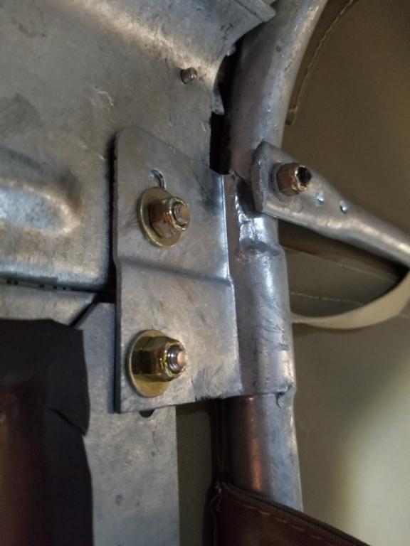

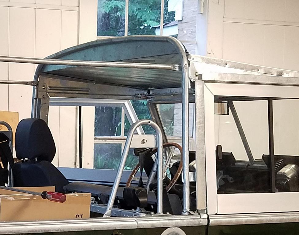

          I had it reversed. It looks like the bracket is correct. Anyway, here's pictures of how it should look and fit.

            Mine are on the right way. Guess this was some sort of manufacturing error from the factory. Planning on a bikini top for spring and summer now anyway...

              Can you post up a picture of the inside of your bracket mount? It almost looks like the top of the side channel may be bolted to the back of the hoop bracket and it has to be mounted to the front.
