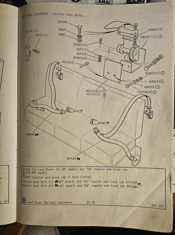

      Could you help me as a Brit in the UK ,Does " Retractors" mean the reel with the webbing on with inertia reel belts ? If so Land Rovers in certain markets did have Reel belts ilo static ones . They are listed normally in the Optional Equipment parts list , not the standard parts list. Certainly S3 were available with such belts. My 1982 Station wagon had static belts & I was able to buy all the brackets and belts to fit inertial reel ones.Click image for larger version

      This is the first set up, from 1975 optional parts list , there are many more some later ones very similar to Defender ones

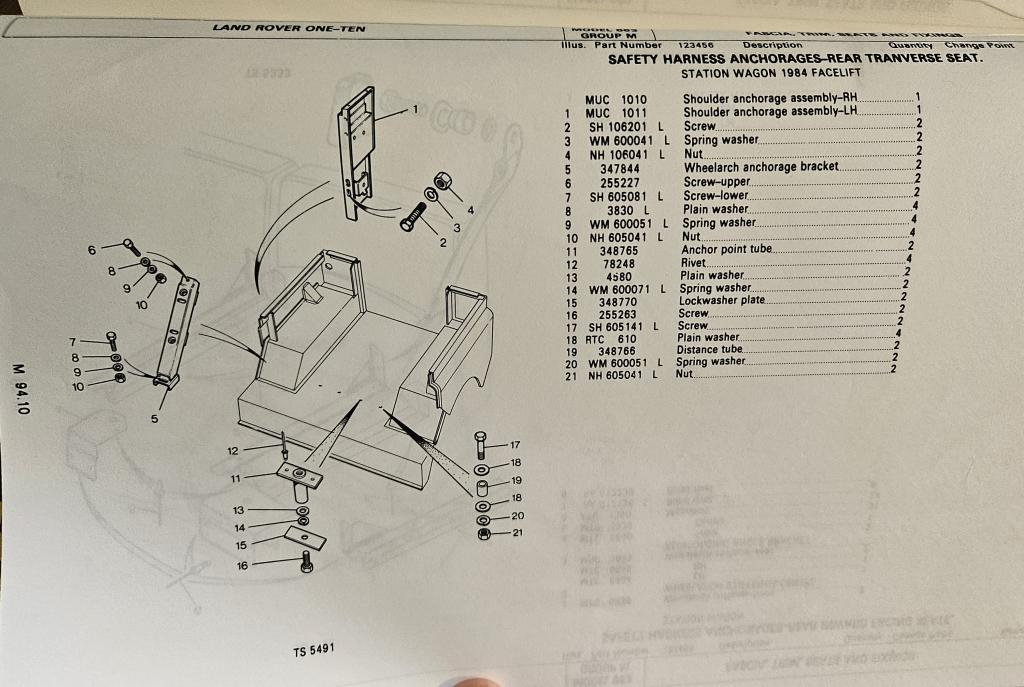

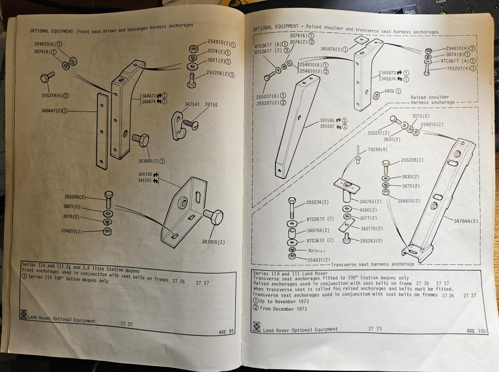

              Originally posted by Lance Dahl
              @roverp480,
              Good day, do you have any photos of putting in the inerita belts/shoulder belts in your Series III wagon? I am trying to do the same thing in my 1983 109 Country Wagon. I am looking for some close ups of the mount at the C-pillar and the mount at the wheel well/door by each outside seat. Thanks for any help anyone can give me.
              Lance
              If you have a truck cab, hard top or Station wagon there is a variety of upper B pillar brackets that will fit. The similar upper mount can be fitted for the second row seats C pillar on 109" or One ten . which can also mount the reel .
              The pictures are from both the S2a / S3 option parts book and early One Ten , which shows better the layout of the anchorages in the rear . MUC 1010 has the facility for the reel to be fitted as well & have also fitted this part to a truck cab .
