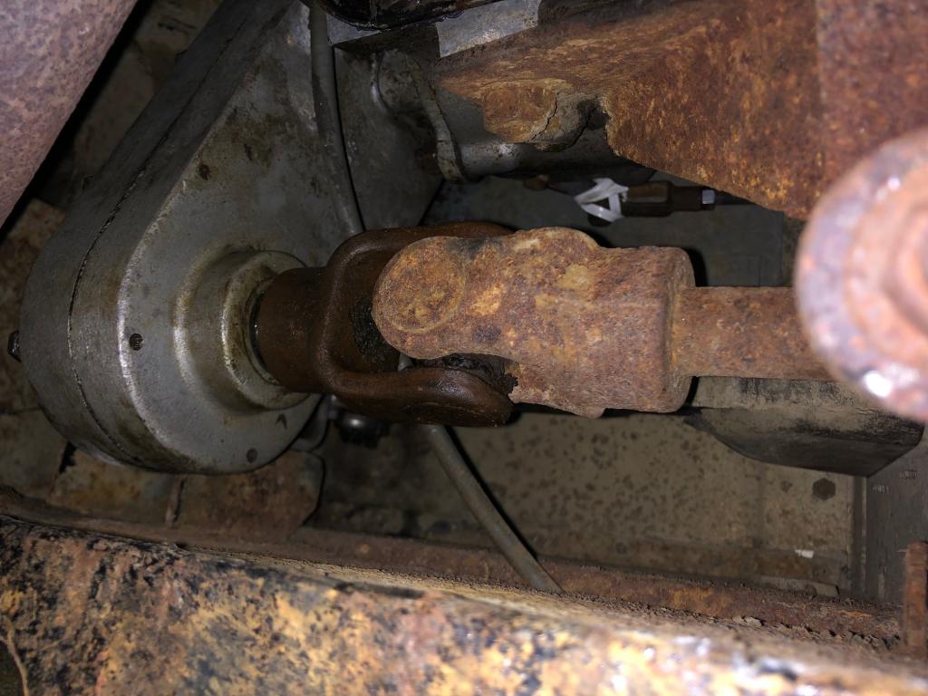

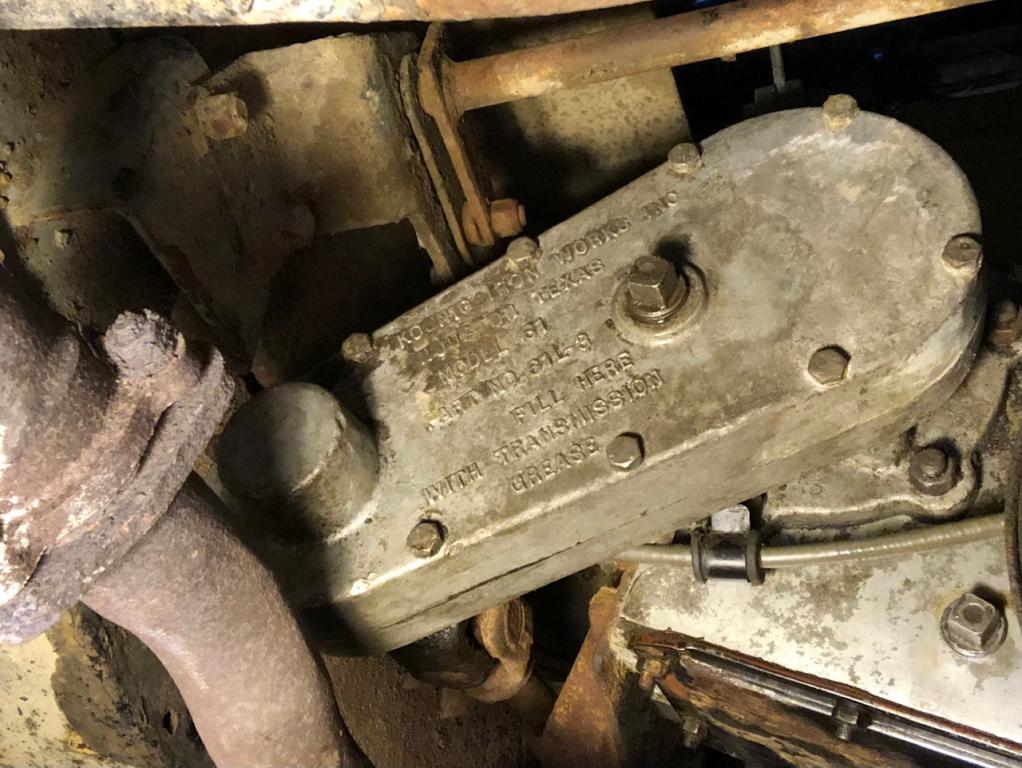

              Thanks for the input, gentlemen. In answer to you, jmrr, yes the PTO shaft runs off the transfer case. Pic attached. And, yep, above the crossmember.

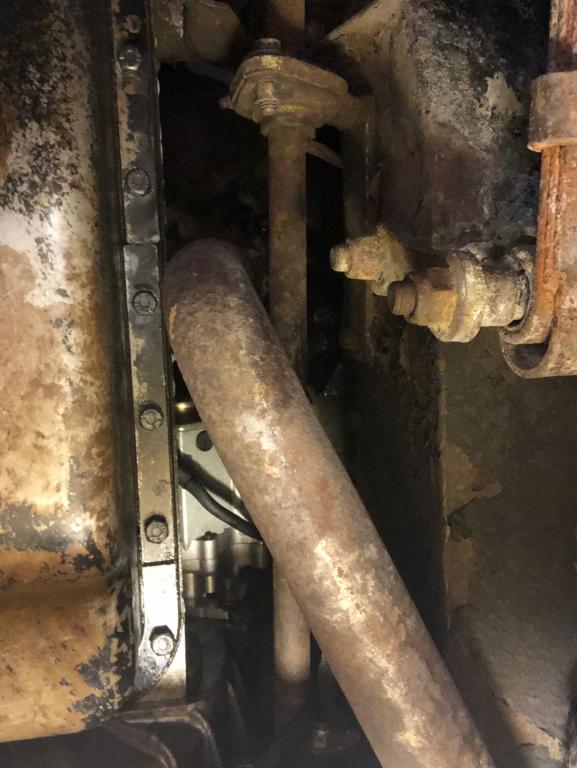

                  #9
                  Could you post an image of where the sahft passes the header pipe? That might help 2 see how tight things r

                      Could you post an image of where the shaft passes the header pipe? That might help 2 see how tight things r
                      It's not easy to convincingly photograph the issue but this pic gives the idea. I'll be giving it a shot and appreciate your wish of luck.
