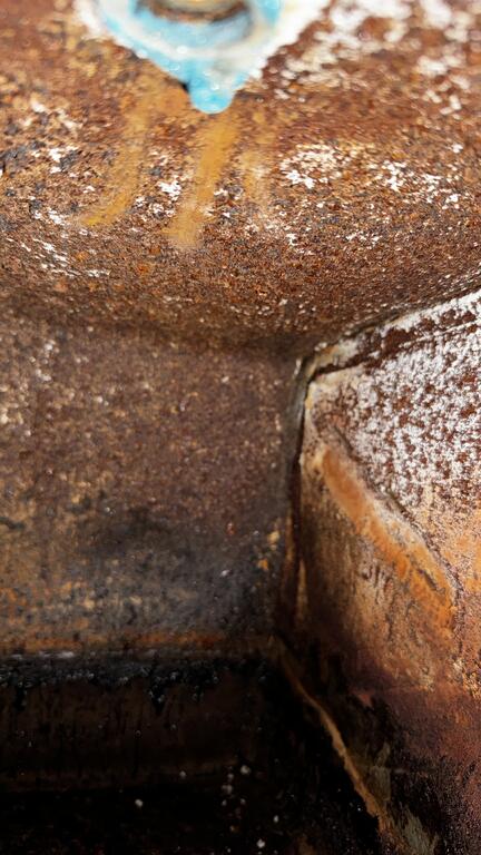

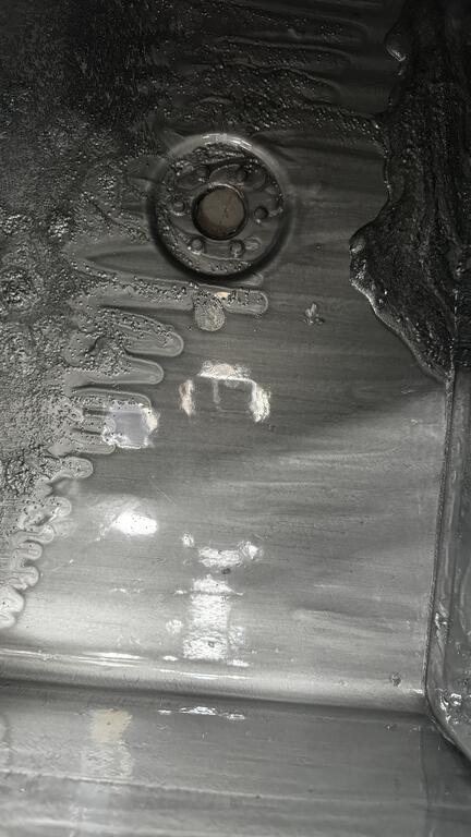

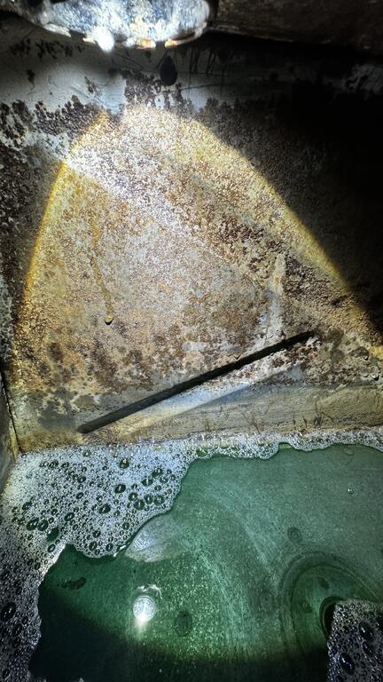

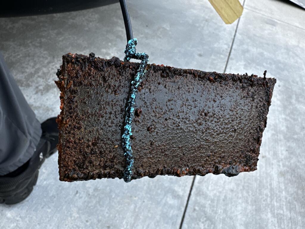

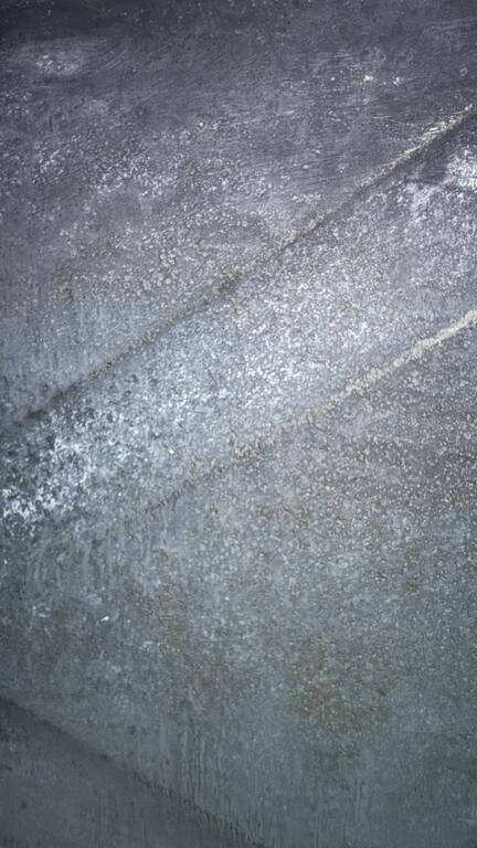

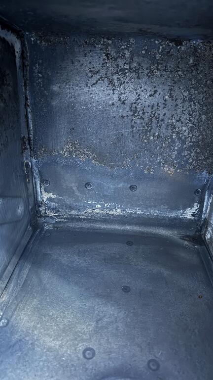

        I see this if a little old, however if there are those in the future interested in doing this, I have recently accomplished the feat..lol I used a kit from KBS(there are others) It's basically getting the old fuel tank as clean as possible and then lining with epoxy. I started my process with electrolysis(grounded the tank and dropped a steel bar with + charge in the middle of the tank, I used an old battery charger) to remove as much rust as possible. Then used a cleaner/degreaser, followed with zinc phosphate and then the epoxy. I'll see ifs I can upload a few pictures of the process.
          not very pretty, had too much epoxy..

            a few more.Click image for larger version
