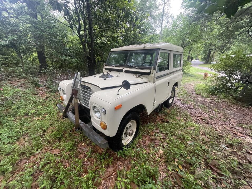

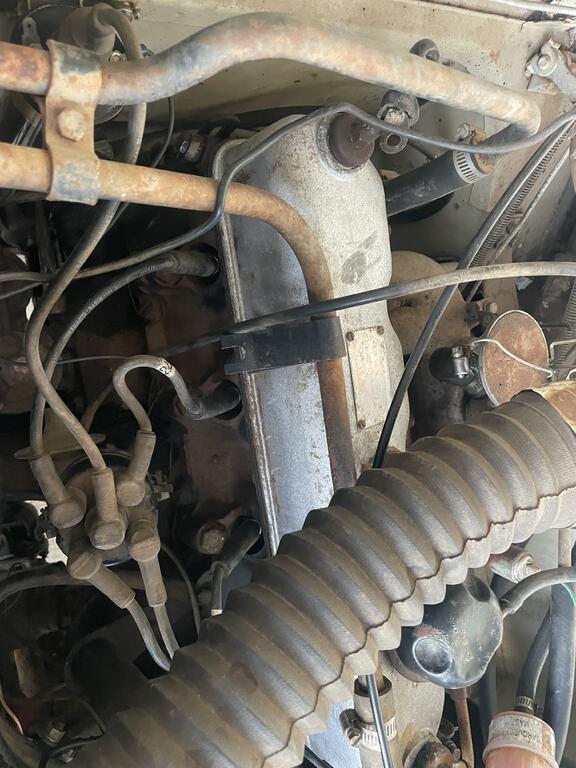

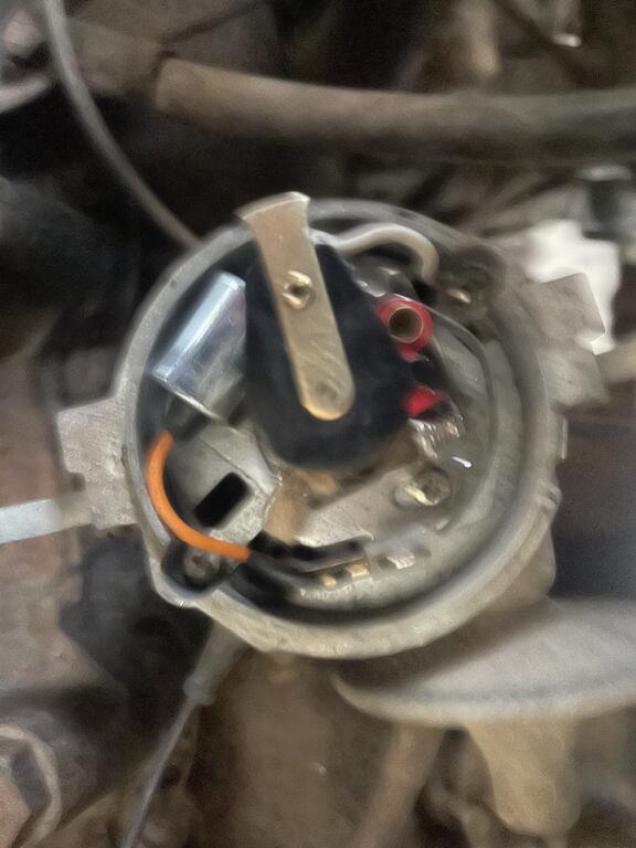

    I come to you all seeking knowledge, because I am at wits end on this engine. Let me take you on a story, last year 2023 september, I serviced the engine on my series III, new distributor cap, leads, points, plugs, and coil. Everything went well, engine ran great, then I had some leaks from my front and rear diffs so I let the car sit for a couple of months, I would start it occasionally and move it around, with no issues. Spring of this year, I go to move it and it is running rough, like pops and bangs and back firing. I move it where I need and shut it off, next day I go out and engine will turn over, but no combustion. I go through the entire engine checking timing, lifter spacing, checktiming, and readjust the points. Boom I get some combustion, but it still runs rough. I table it for another few months and here we are end of December 2024 and I don't even get combustion. I have replaced the fuel, I have replaced all of the original parts on the engine from the service back in September. I will get one cylinder to pop occasionally, but nothing else. I have spark at the points (it seems dimmer after the first few turns). I have spark at the plugs (maybe weaker than what I would think, but spark non the less). We have checked compression averaged in the 140s, I had one cylinder at 130. I am getting fuel to the carb. I don't know what else to check. Again, I can get one pop from the engine maybe every 30 seconds of cranking. I just don't understand how I can go from a running engine to this mess, with seemingly nothing changing.

      You didn't list "condensor" among the earlier replaced parts. Could be that.

        Ditto - I have had these type of symptoms on various vehicles . In order of frequency, condenser ( Capacitor) failing, carb issues, such a blocked jets or stuck none return valves, spark plugs, leads or coil failures and extremely poor fuel ( about 6 times in 50 years)
        Condenser failing can result in symptoms ranging from a slight misfire through severe coughing/backfiring to total none running even if showing a spark from a plug sitting outside the cylinder.
