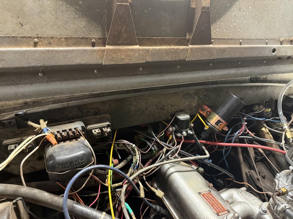

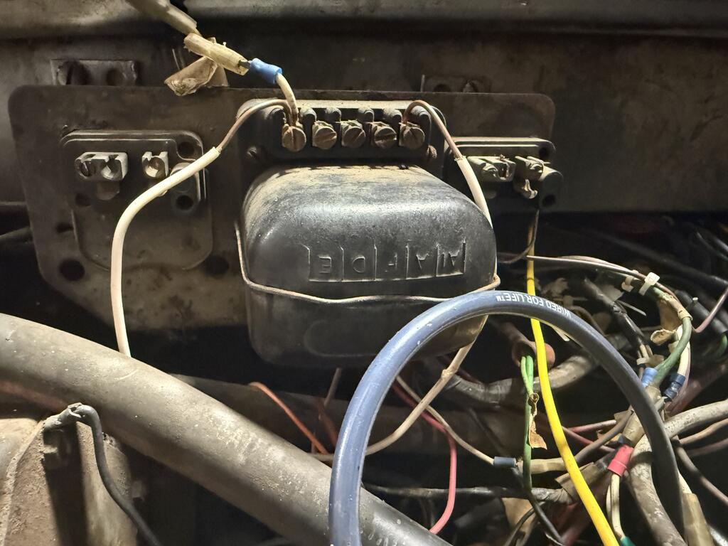

    Hi. I am slowly working through a warren of electrics for 1961 Series 2. Ultimately I’ll buy a new harness and redo it all but for now I’m just trying to fix the brake lights and remove all dead wiring.
    I’ve attached a photo of where the fuses used to be. The vehicle has been converted to negative earth. My questions:
    1. Why are there seemingly 2 redundant fuse boxes on rather side of the voltage regulator?
    2. Given I have failed to find any fuses anywhere, how should I best proceed to add fuses back into the correct location as I try and gain some semblance of organization again?
    thanks.

    Firstly, the fuse box covers seem to be missing....or did you remove them temporarily? IMPO, changing polarity to negative earth is ill-advised. Originality is, at least in my shop, GREATLY appreciated. ALWAYS. I've recently found some original fuses but they're still overseas and spoken for by 2 of our regular clients. I 'll look for more and hopefully have more soon. Returning to positive earth is quite straightforward and I believe will serve you well in the long run. Your wiring looks scary...carry a fire extinguisher, minimally, and I HIGHLY recommend fitting a quick-disconnect battery terminal .

      Thanks charles1943 appreciate the input. The fuse box covers are sadly long since lost in its prior life. I have enough non original I've decided to stick to the alternator conversion including the -ive earth.
      You are right on the fire hazard - I have the extinguisher and have actually just ordered a new harness and plan to tear out the mess for the reasons you mention!

              Regarding the two fuse holders, the early vehicles had only one fuse for ignition controlled items like brake lights, fuel gauge, and wipers . These would have green wires from the fuse. Station wagons and other vehicles with an interior light and would have the extra fuse holder for that circuit . This would have brown/ blue feed wire from the voltage regulator (A1) and purple to the light
