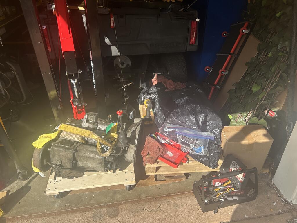

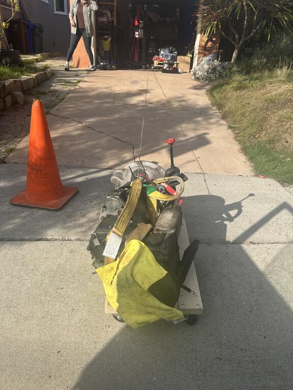

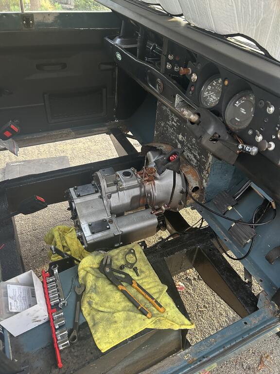

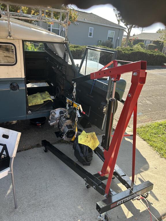

        Here’s some photos of the install…
        I used a Harbor Freight hoist and engine leveling kit, and a winch to pull it up my angled driveway. I did it in the street in front of my driveway because I didn’t want to remove the only braking method on a slope(I didn’t trust wheel chocks alone to hold the truck while I was under it).
