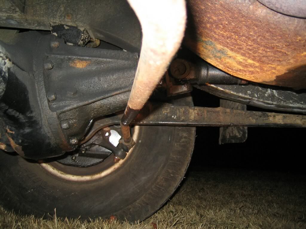

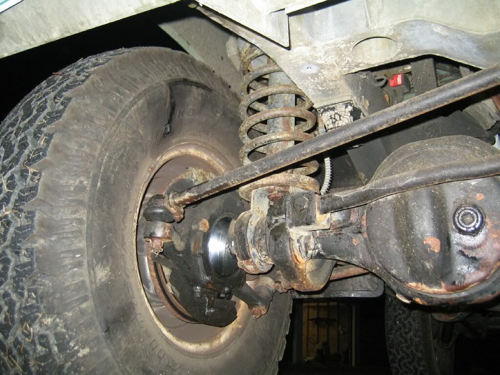

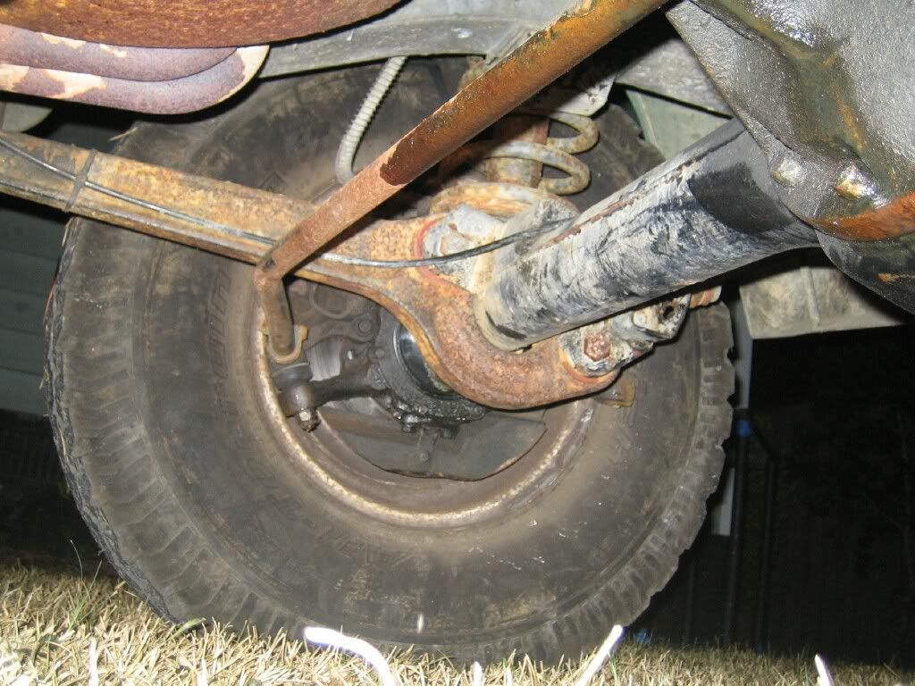

    Heres a better angle of the leak. I also included a pic of the bent tie rod. Drivers side is fine...passenger side...not so fine. Looks like I'll also need a new seal at the front as well.

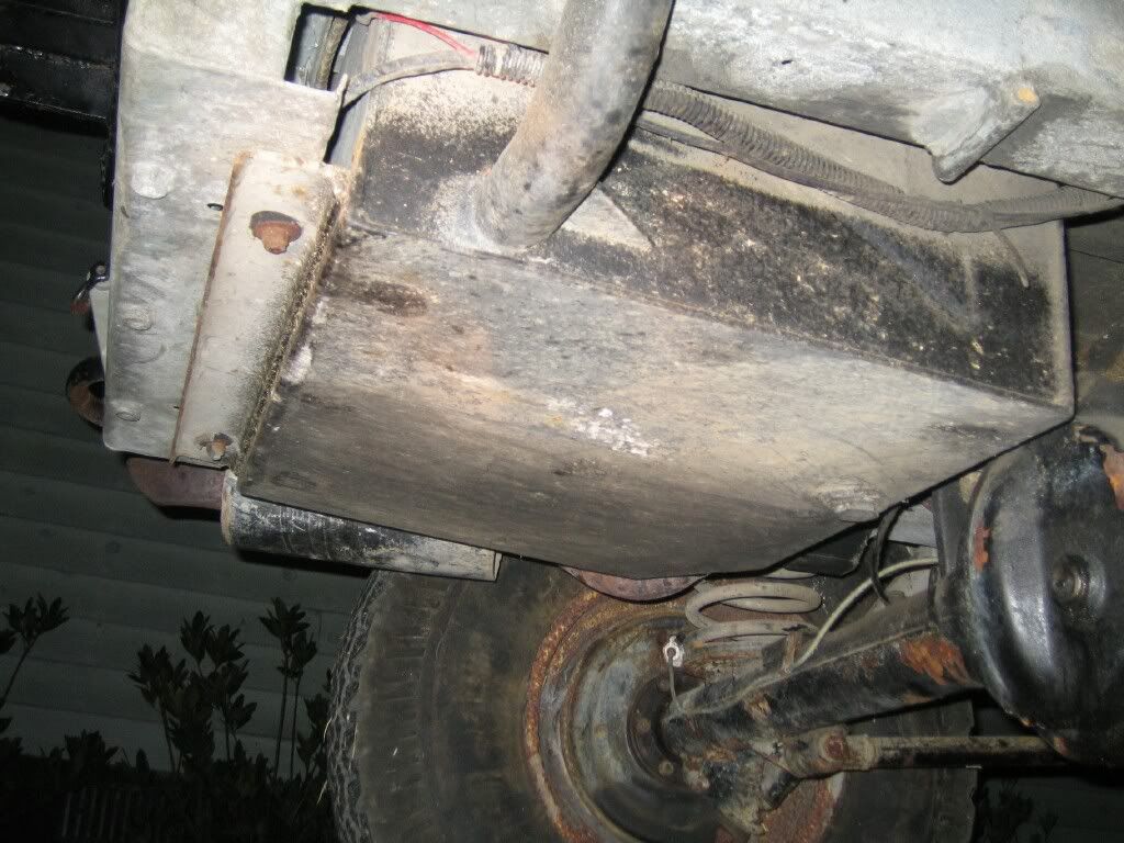

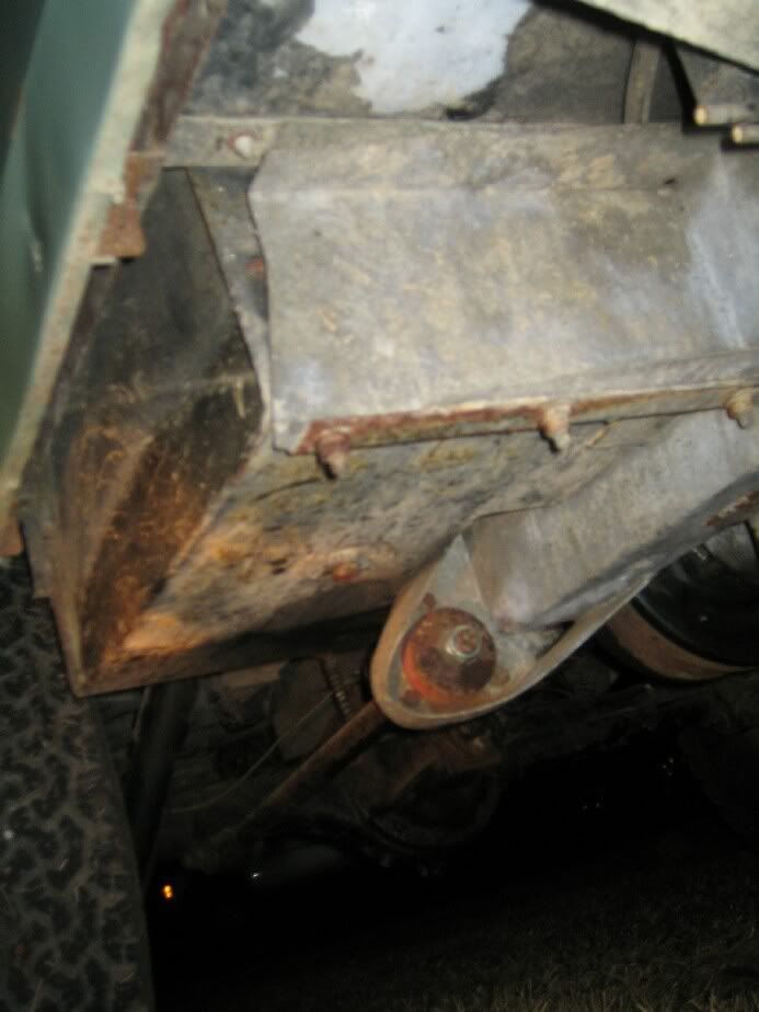

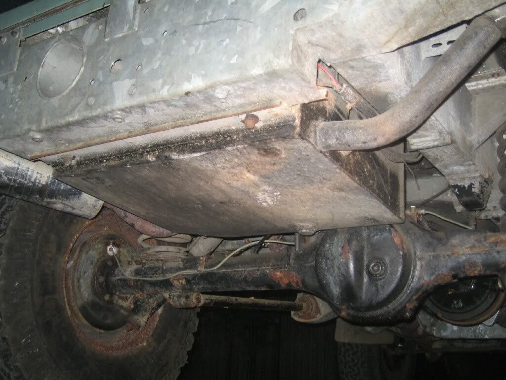

    Also included a few pics of the side and rear fuel tank. Hope this helps out.
    From the front....
    Fuel tanks.....

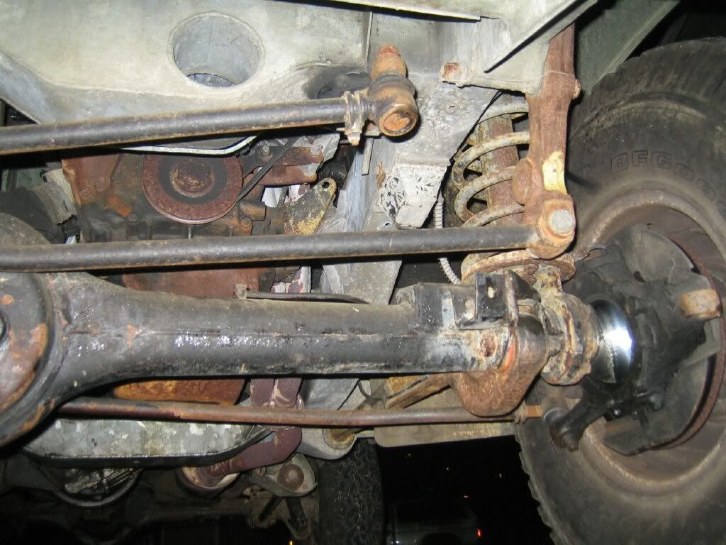

        Your fan belt looks a little loose, your lower radiator hose clamp needs tightening, your driver side tire has a slow leak...
        Seriously, though is the front diff supposed to be angled that much. That doesn't look normal.

            jp-
            that is how the coiler axles are set up.
            I like the rear tank, looks like a cut and welded 109 SW tank, or perhaps completely custom.
            most curious though is the complete lack of a transmission crossmember.

              From what the previous owner told me, the whole frame was custom as well as both fuel tanks. Same goes for the smugglers box under the drivers seat.
                Actually that is pretty standard unless you have an ex-military Rover and thus both you and your passenger get to sit on a fuel tank!
                Even if stuff isn't as 'custom' as you thought, you still have a great truck and if it isn't custom is easier to fix and or replace if there is a problem.

                    Does your emergency brake work well?
                    When you have the driveshaft off, you might want to pull the emergency brake drum, too. It's hard to me to believe that you don't have gear oil on the shoes inside.

                      The ebrake works pretty good but doesn't seem to be tight or have a lot of tension when pulling up the ebrake handle. I'll have to look into that as well. Another thing for me to be aware of. thanks!
