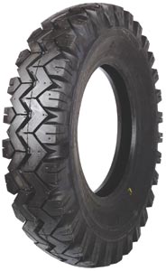

              Another 7.00-15 vintage alternative...
              Description
              700-15 STA Super Traxion
              Details SKU:59132
              Construction: Tubeless 6 ply nylon
              Load Capacity: 1720 @ 45 psi
              Overall Diameter: 28.75
              Tread Width: 6.25
              Price:$ 104.00
              universaltire.com
              Cheers, Thompson

                      I've got the Super Traxion's on my 88". I like them, but man they get flat spots easily. If I don't drive it for a week, you can feel the flat spots for several miles. My 235/85/16's never did that. Perhaps the load rating on the tire is a bit much for the 88".
                      Maybe that will go away with more miles on the tires. And they do have some incredible tread depth. I think it will take quite a while to wear them out.

                        Arent the Super traxions Bias ply? Bias plys always flatspot to some degree. It is really a shock for people when they go from radials to bias and aren't aware of that happening.
