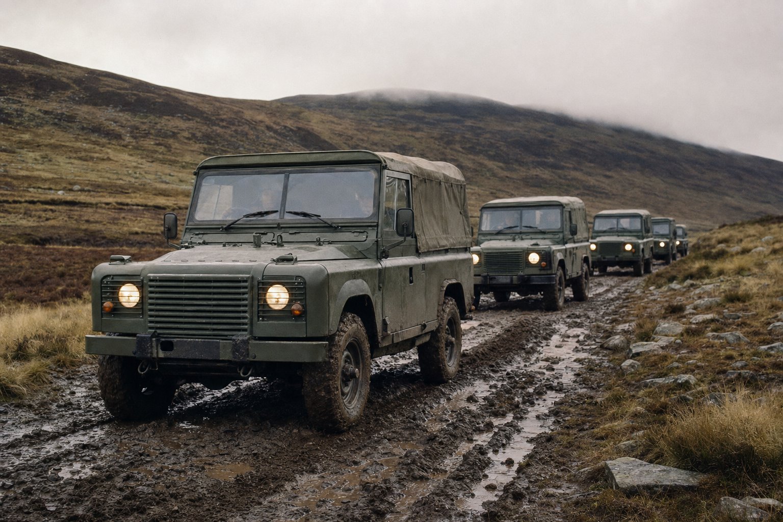

If someone can explain this one to me, let 'er rip.
Sometimes I have to ask myself...why????

I saw that the other day and got a good laugh out of it...
Presumably its redundancy, when one axle fails you have another
the real reason for this configuration is to increase payload capability. what doesn't make sence is there is so little volume capacity that you need a vary dence payload to reap the benefits. maybe he was thinking of becoming a lead hauler'64 Series IIA 88 Canvas Tilt

well, six by six is cool if it works. but that looks like a poor conversion.

It looks like a kit car or something. I know that it is not, but it has to do with the wheel clearance.
He would almost have a better chance selling it, if it were olive drab, plain wheels, without all the "EXTREME, OFF-ROAD"-flare, but instead with an EX-MOD persuasion to it, so it looked like one of those "one-of-a-kind" units that you see in Land Rover publications."I can't believe I'm sitting here, completely surrounded by no beer!" -OnslowComment
I bet the extra axle isn't driven, even if it was they should be a little farther apart, and with that wheel base I bet its not fun to steer on the pavement.Comment
It looks like a 125" wheelbase Sandringham 6 built by Hotspur Motor Cars in the UK. They did series, stage 1 and Defender versions IIRC and were mainly geared towards things like heavy cherry pickers, tippers and other commercial uses. That one has been blinged out sadly.
They were 6X6 with a drive through diff on the middle axle although there is no diff between the rear two axles so scrubbing is an issue. THe suspension was fairly neat as one axle had 88 mounts and the other 109 mounts so that the two systems could overlap allowing the wheels to position that close together.
My favourite is still the Centaur halftrack.Comment
