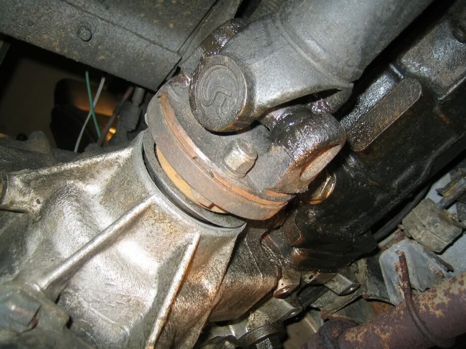

    So when I start driving the rover, I get this loud ringing/clanging noise as if a big thin aluminum washer was tumbling and banging around in a dryer.
    Brief Vehicle History:
    -LT77 5-speed Transmission / LT230 Transfer Case (Full time 4 wheel drive ...low/high without diff locked....low/high with diff locked) / D90 axles

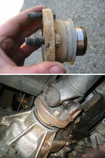

    At first I discovered the mud shield on the front output shaft (where it connects to the transfer case) was loose and produced the same sound. I fixed that hoping the sound would be gone. Nope. Its back. I'm thinking its something inside the transfer case itself.
    Any ideas on what this noise could be? All gears shift smoothly...no grinding. It will go into low/high with and without the differential locked fine with no problems. I have no performance issues with the vehicle...its just that the noise is so annoying!
    Any suggestions would be great! thanks!
    Below are pics of the transfer case as well as the front output shaft mud shield that was loose and is no tight. I thought that was the noise issue but its not...

    did you try alternately removing the front and rear propshafts to see if that made the noise go away?
    did you notice that your gearbox is cracked next to the drain plug where it bolts to the transfer box?

          Yes we tried removing both prop shafts...the sound did not go away. It sounds just like a then aluminum washer jingling around in a metal box. I'm gonna have to take out the panel under the middle seat and drive with it open to see if I can diagnose the area where the soudn is coming from...
          And yes I did notice the gear box was cracked. Its been like that for quite some time now with no problems or leaks.
          I just replaced the rear output shaft seal as well as the ebrake shoes....ebrake works great...sound is still there.
