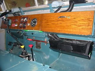

I put this unit in my ser1. Fabricated a manifold with flaps and plumbed in a ball valve for control. Twin squirrel cage fans and 3 speeds. Rated at 25,000 BTU's. Bought it from Princess Auto (agri./industrial supplier) for around $200 CAN. I can drive with my window open no matter what the weather.

I picked the heater up from JC Whitney and ran coolant hose under the bulkhead to and from the unit, using a secondhand middle seat panel. It worked great except at 45 mph or more.
