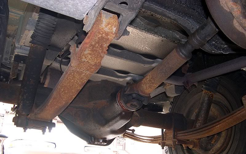

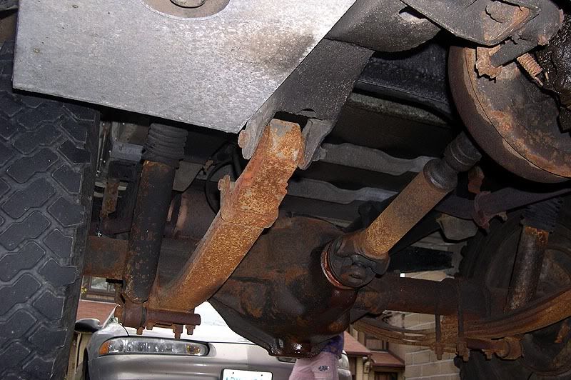

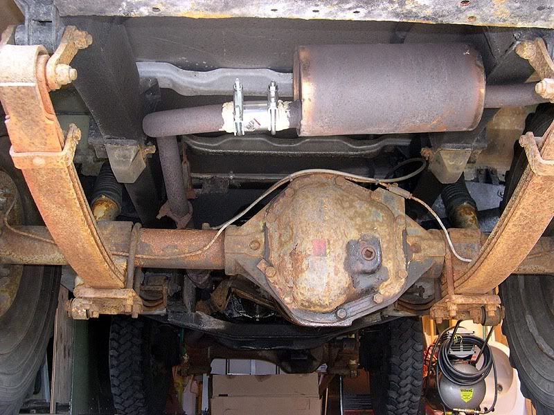

I installed a Salisbury axle under my 88 at least 10 years ago now. It is a pretty easy swap really. The spring mounts need to be cut off and moved in to line up with the 88 springs and the prop shaft needs to be shortened 1.85 inches. I had a drive line shop do the prop shortening.
I did find though that the first time I really had to stand on the brakes, I got a hell of a knocking sound coming from the rear end. Seems the nose of the diff was dipping down under braking and the u-joint was binding up. Also was getting a bit of propshaft rumble (very much like so may 101's do) on the over run. We ended up redoing the spring perches so the nose of the diff was pointing slightly up. Cured the knocking but not the rumble.
If I remember correctly, I had the longer military rear shackles on when we did the swap, but later when I got the parabolics, I went to the standard length shackles. Don't know if the longer ones played a part in the knocking or not.
I've been told that you can solve all the issues if you go with the double cardan type u-joints, but the rumble does not bother me and it is easy enough to avoid while driving.
Also, I left the 11 inch drums on the axle as I was going with 11 inch all around. Swapping to the 10 inch drums is straight forward nuts and bolts.
Good luck with your swap.
