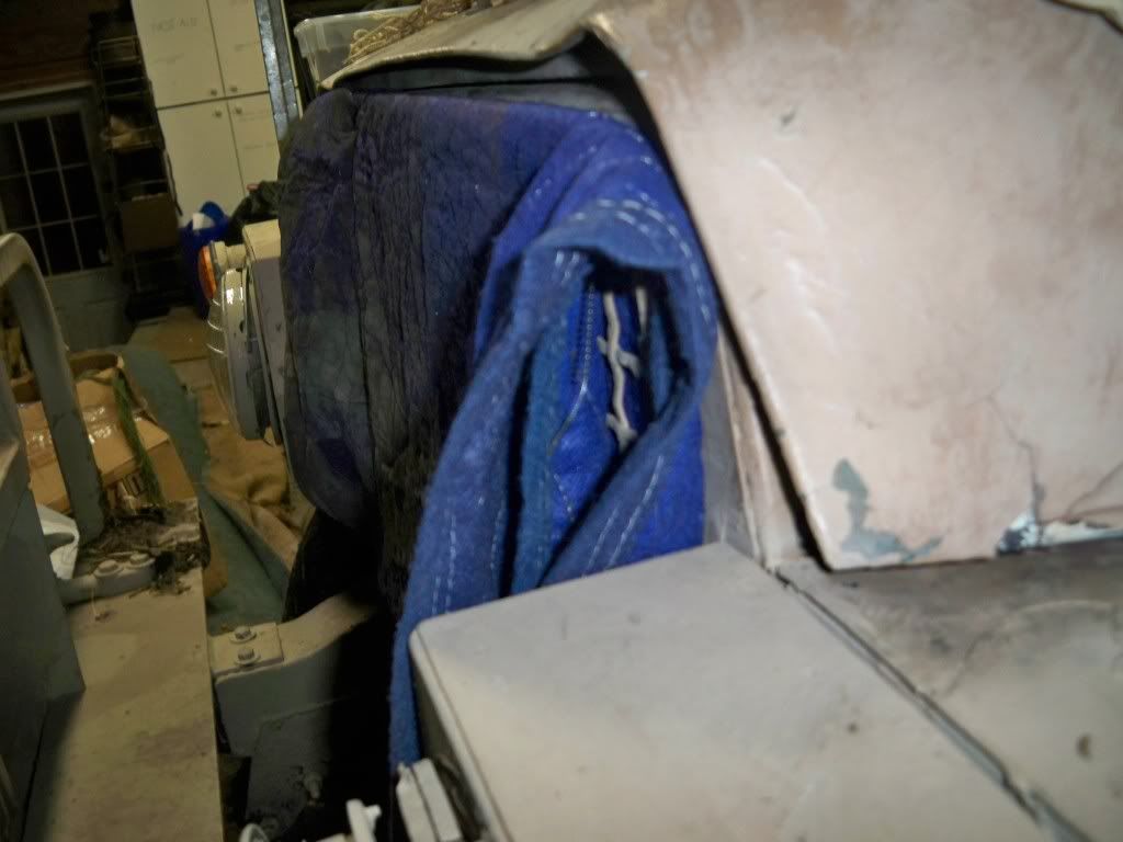

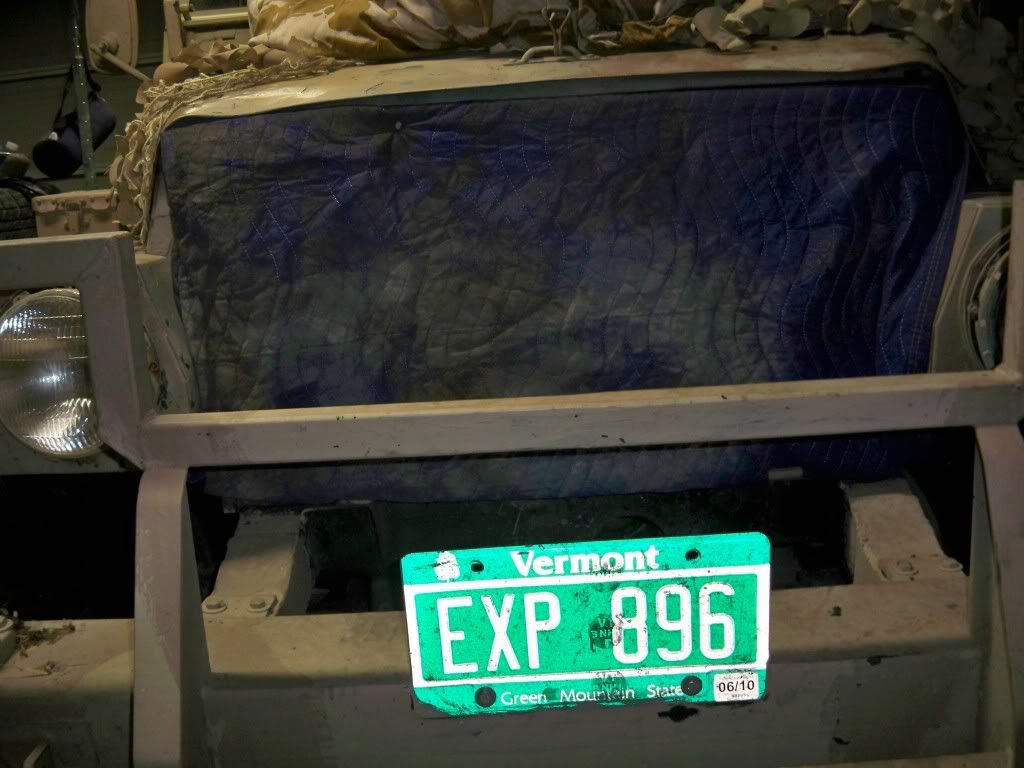

    Hey Guys,
    I will be running my 1975 RHD 24v Lightweight soft top this winter and I wanted to know if anyone had any ideas to make it a better experience. I have installed 235/85/16 studded snow tires so that should help. I have also built a somewhat basic (but I have no idea how effective) radiator muff out of a moving pad as no-one stocks one for a lightweight. Also when should I use it? and should I cut a flap in it that I can open to increase airflow? Are there any other things I should do to the Rover this winter? Thanks for all the help.

      I would cut a flap in your muff for when you drive on the highway. You can install a fume curtain in your soft top (cloth that seperates front cab from back cab) to minimize the cubic feet your heater needs to heat. I would definalty reccomend waxoyl or some other rust preventative on your chassis to combat the salt along with frequent washings of the undercarriage.

        I have a roll bar fitted and I have a blanket separating the cab from the back. What temps should I have the muff fully closed? I mostly drive small roads at about 50 mph with very little highway use. How hard it it to waxoyle the frame it is some thing I could do or do I need to take it to a special place. Also would it be worth replace my thermostat with the 190 degree one our host make and how hard of a job is it to do that.

            I run a bog standard 195f thermostat all year round in my 2.25 petrol. it is the common one used in 350 chevs and such. It will fit right into the base of the thermostat housing like it was made for it. The only mod is to make a spacer that makes up for the room of the skirt on the original stat. I made one out of a copper strip and soldered the ends together to form a ring to take up the space of the skirt so the O-ring can do its job. I have had one in 5 years now and still works great. Not bad for a $10 Napa part.
            For in town,~30mph, I leave the rad covered up below freezing. Higher speeds, open it a bit. Highway running open it quite a bit. When it gets really cold, ~20c, I keep it all buttoned up all the time. I keep an eye on the temp guage to see if it needs adjustments.
            Keeping the rad covered makes it warm up faster and retains heat better when parked for a short bit. It also gives your stat a chance to get up to temp.
